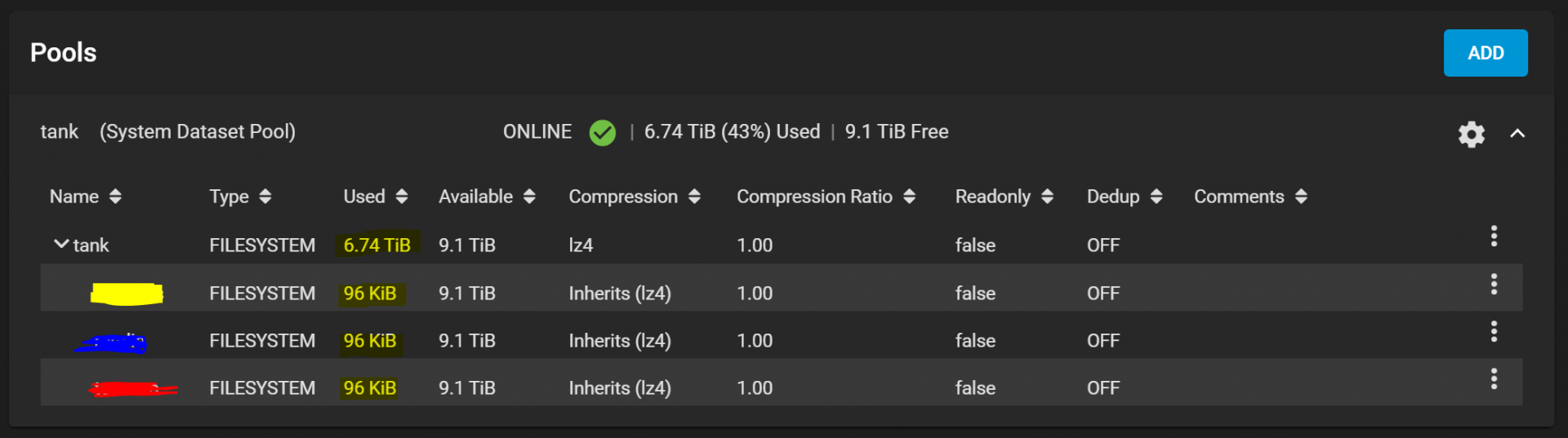

I have spent a bit of time trying to figure this out myself but haven't really been able to get anywhere and am hoping that someone here can help out! I have a mirrored vdev setup for a single pool with three datasets. I am using NFS for my unix servers and SMB on windows and am running into an issue where the data written over NFS is undetected within SMB and within the TrueNAS datasets. The screenshow below shows that 6.74 TiB has been used but nothing is showing under the datasets:

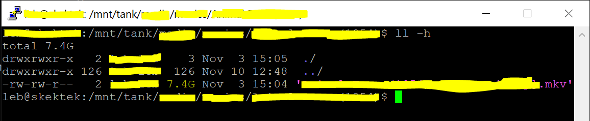

Perplexingly, empty directories are being shown under the TrueNAS web shell as follows:
But under NFS mounted to a different system I see:
