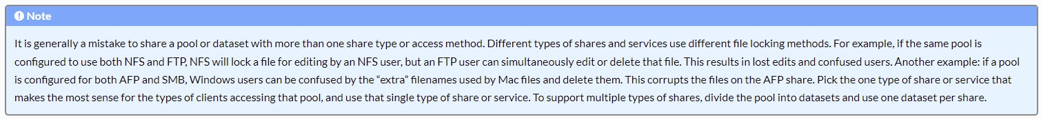

Just letting you know that what you're trying to achieve is not recommended.
Refer to Sharing in the documentation.
