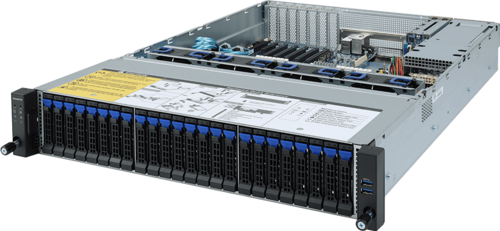

Whoops meant to write 4, taking me to 20/24. I basically have these 2 options for my 24 2.5" NVME server:
- https://www.supermicro.com/en/Aplus/system/2U/2114/AS-2114S-WN24RT.cfm
- https://www.gigabyte.com/uk/Enterprise/Rack-Server/R272-Z32-rev-A00
It's to my understanding that if I utilized all 24 bays I would be left with 1 usable slot which would be taken up by a 10 Gbe SFP+ NIC if I am unable to use the onboard networking. The purpose of this server is to house our live projects for Production and act as the server head for a JBOD that houses it's backup and archive projects so I need 1 HBA card as well. I have to lose 4 drives to be able to use a NIC and a HBA in at the same time right?

Ah right, that was my worry basically. So my options are to go with that all flash config and have the potential for network upgrades in the future or 'downgrade' to a server that has 24 hotswap SAS support instead and go with that, that would allow me to use an HBA and NIC without losing any bays as well I think. Something like this:

So yes that appears to include a 12Gbps SAS expander, so that's probably a viable option. And that means support for 12Gbps SAS devices, which in turn means that when you put a 12Gbps SAS HBA in there, you get 48Gbps from the HBA to the SAS backplane (because there's four lanes in an SFF-8643 cable).
