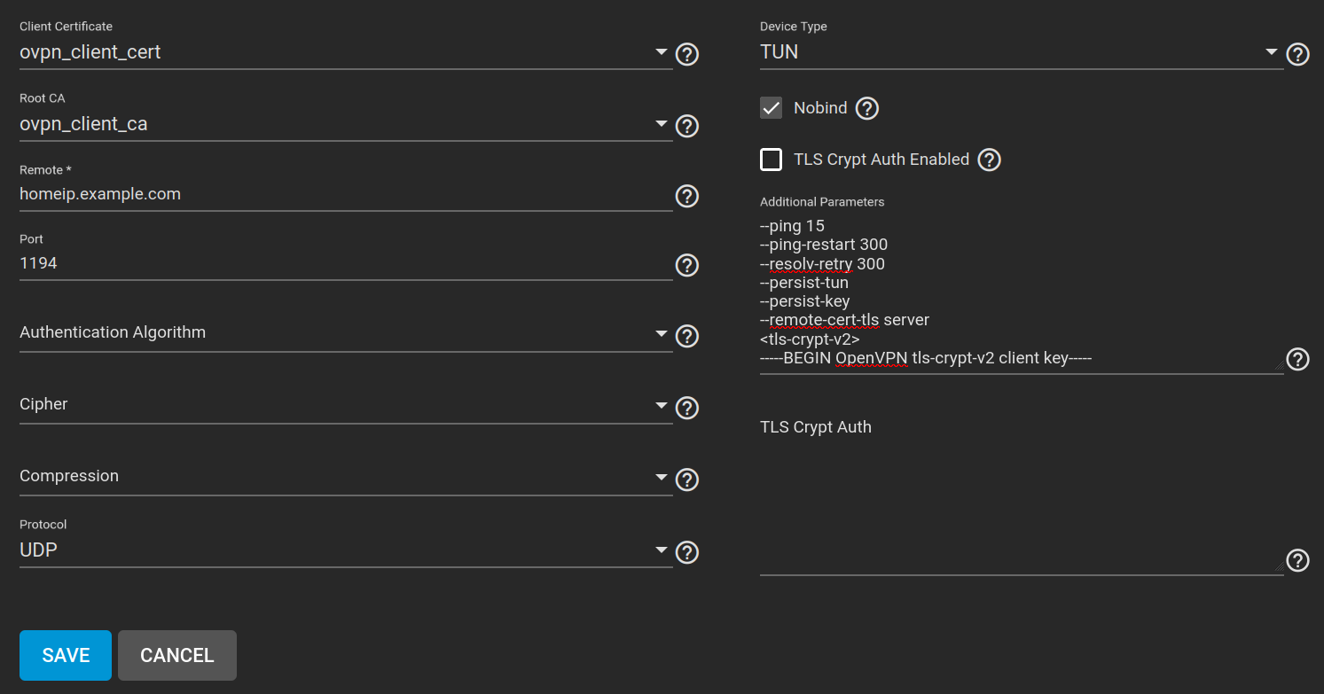

Here are the settings I have in my OpenVPN client config. Note that there are no further options beneath <tls-crypt-v2>, just the key.

My client's options are:
Client Certificate: ovpn_client_cert
Root CA: ovpn_client_ca
Remote: subdomain.example.com
Port: 1194
Protocol: UDP
Device Type: TUN
The rest look like they're at their defaults.
My client's "additional parameters" are:
--ping 15
--ping-restart 300
--resolv-retry 300
--persist-tun
--persist-key
--remote-cert-tls server
<tls-crypt-v2>
-----BEGIN OpenVPN tls-crypt-v2 client key-----
-----END OpenVPN tls-crypt-v2 client key-----
</tls-crypt-v2>
