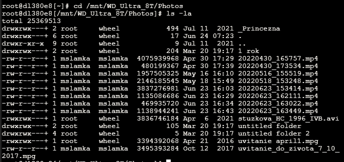

I updated TrueNAS core 13.0 to 13.0-U1, I also updated pool flag and my samba is not working in the same way as before.
I am using samba on windows, wife on mac, it's mounted on Coreelec. My home directory is accessible but other shares like Photos no. I have read permission for local group "homeuser" which I created and I put created local accounts to this group. No share (pool) is now accessible, I tried to reboot, unmount, recreate permissions. What am I doing wrong? What else should I configurate? Is there any debug guide how I could find problem?
I am not sure I can rollback current version and it is too long waiting for U2. Changing group on filesystem for all pools is too ugly hack for me ....
Thank you

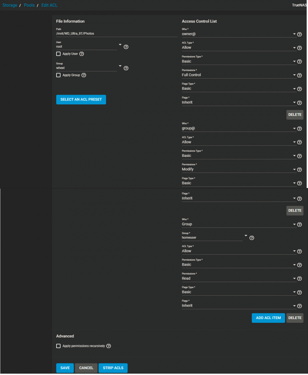

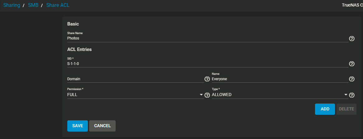

This is my configuration.
I am accessing from Windows 10 Pro, I am logging as TrueNAS user mslamka. I can't see files. From Coreelec I see files, but I can read them.
Please can you be more specific what should I do?
Thank you
m
c77dk
Nov 27, 2019
468

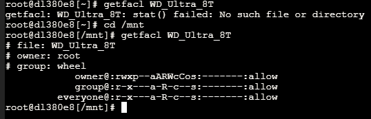

do you have any ACLs on the pool? getfacl WD_Ultra_8T

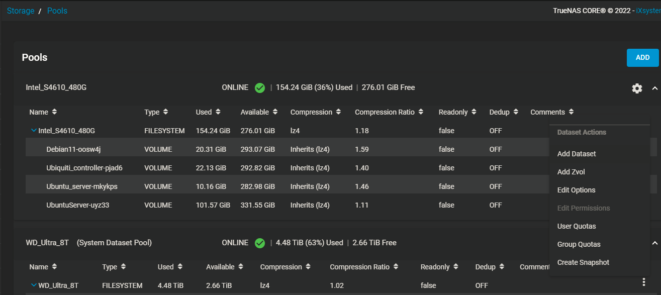

@RogerCWB thank you
@c77dk
as RogerCWB wrote, it's disabled, here are some screenshots
root dataset permissions cannot be edited.
looks quite like mine (mine also has "D" on owner, but since that's "delete_child" that doesn't seem to have any impact on your issue) - it was worth a shot.
