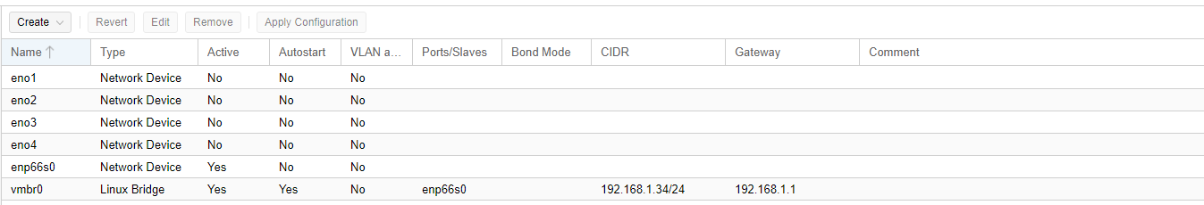

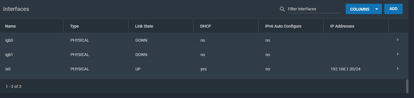

If you have multiple NICs in the machine, even if not designated for iSCSI traffic, you may have inadvertently created a scenario where there are multiple paths to the TrueNAS machine (eg: via routing from another subnet).
Can you describe your network config (NIC count, IP/subnet/VLAN) of the ProxMox machine, as well as provide the output of multipath -ll from it?
frankw
Jan 20, 2021
4
@HoneyBadger that was my first thought as well. I had a 10Gbe and a 1Gbe but on the same subnet on the TrueNAS box. However, I disabled the 1Gbe interface and the issue remains unchanged.
Proxmox also only has one physical interface
multipath on the proxmox box also does not seem to detect multiple routes to the TrueNas box
