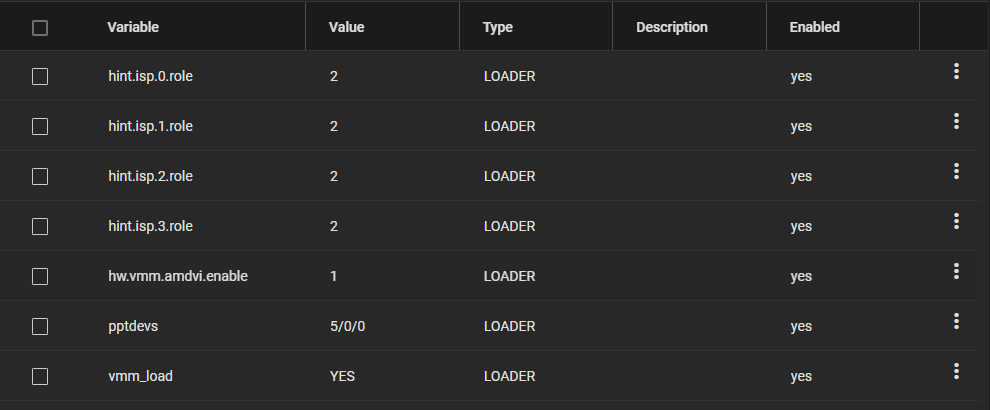

Here are my system tunables:

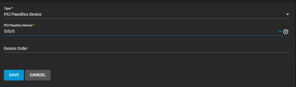

And here is how I tried to add a PCI device to my VM:
For your reference, this is the guide I've followed: https://www.youtube.com/watch?v=i0MAZBX7P-U
Please let help me with this, and please let me know if you need any extra information. Thanks in advance.

Hi, I just stumpled on exactly the same issue. My tunables and passthrough look identical, however the device is not accessible in my VM. Any solution to this?
Hey there,
I never found the solution to this problem, so I migrated to SCALE instead. I've had no issues with it so far.
