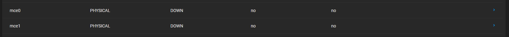

New TrueNAS install, running TrueNAS-13.0-U3.1. I had a Chelsio 10G card installed but wanted to upgrade it to one of the Mellanox 10/25G cards that I had pulled out of another server. The interfaces show up in the console, but show the link state as DOWN, even though I have lights on the card, and the switch (Unifi Agg Pro) shows that it's connected at 10G.
Output of dmesg | grep mlx shows:
root@truenas[~]# dmesg | grep mlx
mlx5_core0: <mlx5_core> mem 0xf6000000-0xf7ffffff irq 26 at device 0.0 on pci3
mlx5: Mellanox Core driver 3.7.1 (November 2021)uhub7: 2 ports with 2 removable, self powered
mlx5_core0: INFO: mlx5_port_module_event:707:(pid 12): Module 0, status: plugged and enabled
mlx5_core0: INFO: init_one:1660:(pid 0): cannot find SR-IOV PCIe cap
mlx5_core: INFO: (mlx5_core0): E-Switch: Total vports 1, l2 table size(65536), per vport: max uc(1024) max mc(16384)
mlx5_core0: Failed to initialize SR-IOV support, error 2
mlx5_core1: <mlx5_core> mem 0xf4000000-0xf5ffffff irq 25 at device 0.1 on pci3
mlx5_core1: INFO: mlx5_port_module_event:707:(pid 12): Module 1, status: plugged and enabled
mlx5_core1: INFO: init_one:1660:(pid 0): cannot find SR-IOV PCIe cap
mlx5_core: INFO: (mlx5_core1): E-Switch: Total vports 1, l2 table size(65536), per vport: max uc(1024) max mc(16384)
mlx5_core1: Failed to initialize SR-IOV support, error 2
Output of pciconf -lv | grep mlx -A 4:
root@truenas[~]# pciconf -lv  | grep mlx -A 4
mlx5_core0@pci0:4:0:0:  class=0x020000 rev=0x00 hdr=0x00 vendor=0x15b3 device=0x1015 subvendor=0x15b3 subdevice=0x0016
    vendor     = 'Mellanox Technologies'
    device     = 'MT27710 Family [ConnectX-4 Lx]'
    class      = network
    subclass   = ethernet
mlx5_core1@pci0:4:0:1:  class=0x020000 rev=0x00 hdr=0x00 vendor=0x15b3 device=0x1015 subvendor=0x15b3 subdevice=0x0016
    class      = network
    subclass   = ethernet
The server is a Supermicro X8 board.
jgreco
Resident Grinch
May 29, 2011
18,680
