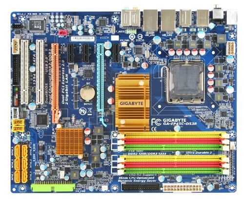

Gigabyte ga-ep45c-ds3r board
Intel Q9950 quad core chip
8GB Kingston Hyper RAM
LAN: Realtek 8111C chips (10/100/1000 Mbit)
This is a backup system I've been using for several months now.
