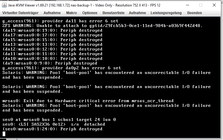

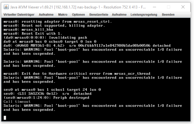

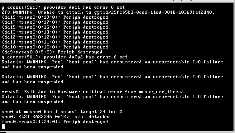

Hello,
i need your help! my Backup-TrueNAS has an error =>Solaris: WARNING: Pool boot-pool has encountered an uncorrectable i o failure and has been suspend.
after reboot=>

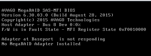

Controller was not found (LSI MegaRAID 9361-8i)
after a longer time power off, controller comes back und found all disks, but now the error comes back again
i can't type anything
How do I get back my data and the backup that are on the system?

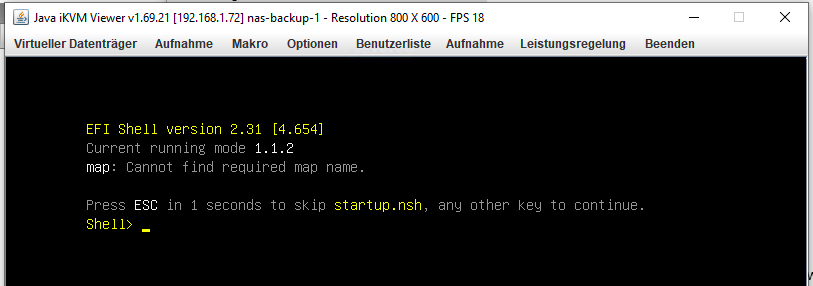

when i reset the server over IPMI, LSI Controller does not come back. I will quickly order a new controller
when i turn off the server over IPMI, wait and start again, the controller boot and find the disks
when booting
but now nothing
i wait for the new controller and hope i will be boot.
