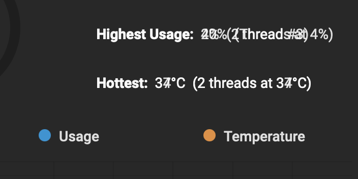

I do get some graphical issues in the webui dashboard for the cpu cores. Been getting ever since installing 12
Samuel Tai
Apr 24, 2020
5,399
Standard procedure for GUI issues after upgrades is to clear your browser cache and history.
j_r0dd
Jan 26, 2015
134
I did clear cache and history. I probably should have tested on other browsers before posting. Looks to be an issue specific with Safari. Firefox looks fine.

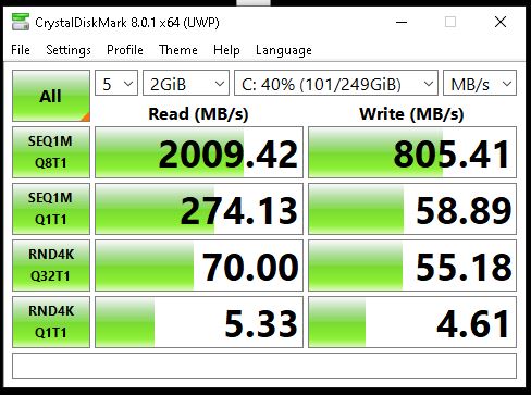

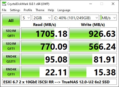

Performance has improved greatly across the board with 12.0-U2 release. Previously FC was the only protocol that was not showing performance degradation from 11.3. iSCSI is now preforming much better. Bellow tests are done in a windows VM on a pool with 16 running VMs.
12.0-U1.1 iSCSI
12.0-U2 iSCSI
