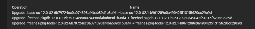

hmm, just installed it but got U1 and no updates available?
wait, it got U2.1 so that is probably it

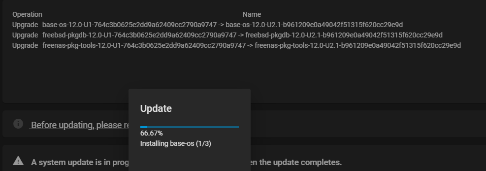

Out of curiousty how long did this take? i've been running this update (Truenas core, home use) and its been running for over 2 hours and i'm not sure how to see progress.

Depends on how fast your boot-media is. Let it keep going though, it'll either fail or finish eventually.
Kris Moore
VP of Engineering
Administrator
Nov 12, 2015
620
Ohh boy... I've heard that before... :')
Yea, without knowing that, its hard to say. If its an NVME SSD, I'd say its bugged. Could be a USB 1.0 stick as well though :)
Not-very-passive-but-aggressive
16,958
I had updates take close to an hour and then succeed back when I had a server that booted from USB flash drives. That was no fun and it's why I tell people to find a better solution, these days.
