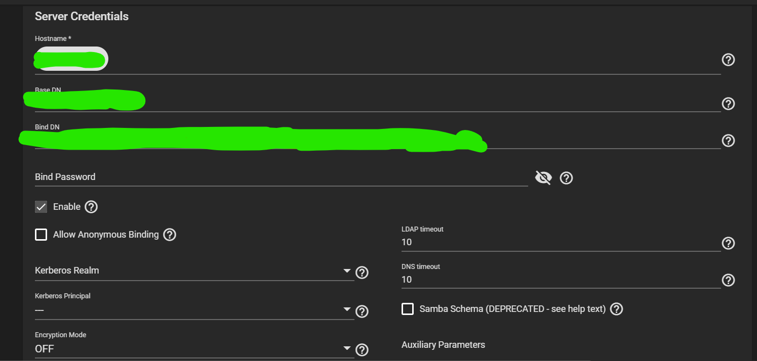

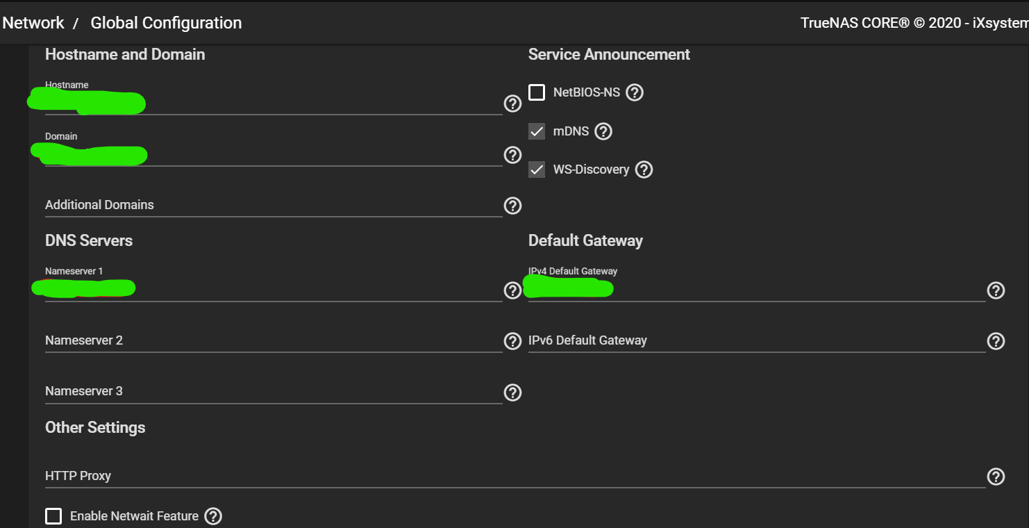

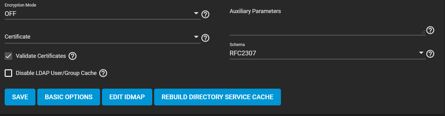

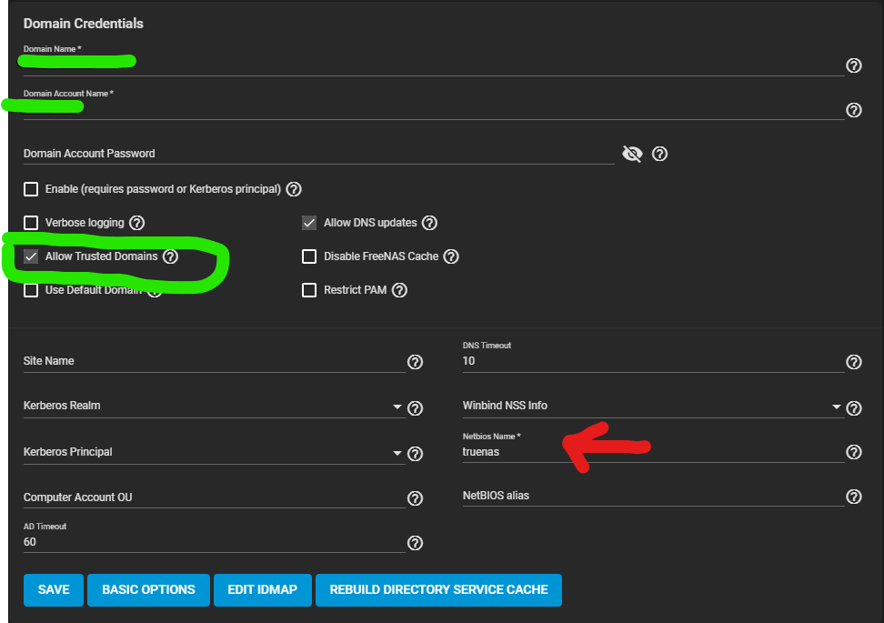

While working on other issues with my new build, I decided to reload TrueNas and start with 12.0u2 (since 12.0u2 was said to resolved some issues with intel chips).
I have no doubt that if someone is on these forums they don't already possess the knowledge on how to join a device to AD. The intent of this is just to walk those who are having trouble with joining TrueNAS to AD with the steps that I had to go through for 12.0u2 to join AD successfully.
Background:
I have three NICS, each on their own subnet (obviously)
Onboard (used for interface) 192.168.20.0/24
SFP Card Port1: 192.168.19.2/30
SFP Card Port2: 192.168.19.10/30
1). Changed the name of my host: Network > Global Configuration: Hostname
2). Set the domain to my domain name.
3). Set the default gateway (the interface gateway is also the gateway my AD server uses)
4). Set DNS Name Server.
Rebooted.
5). LDAP bind (no LDAPS) using a Windows AD account which has delegated control for Read-Only. Ensured the bind was successful. Rebooted.
6). Joined AD using a second Windows AD account with Domain Admin priv.
When joining, I made sure to not go deep into anything crazy. I joined successfully.
Rebooted.
Everything in green are changes I made.

To be clear, we are not using LDAP, we are trying to use the Active Directory function.
TheUsD
Member
May 17, 2013
42
Hey Jedi,
As I mentioned in the post, these are all the steps I had to take to get it to join AD. I had to bind LDAP, too but more importantly, I had to go in that order.
You can always disconnect the LDAP bind after you join AD.
I noticed that I posted the same screen shot twice in the directions. I updated it with the AD Screen shot. Maybe that is what created confusion.
