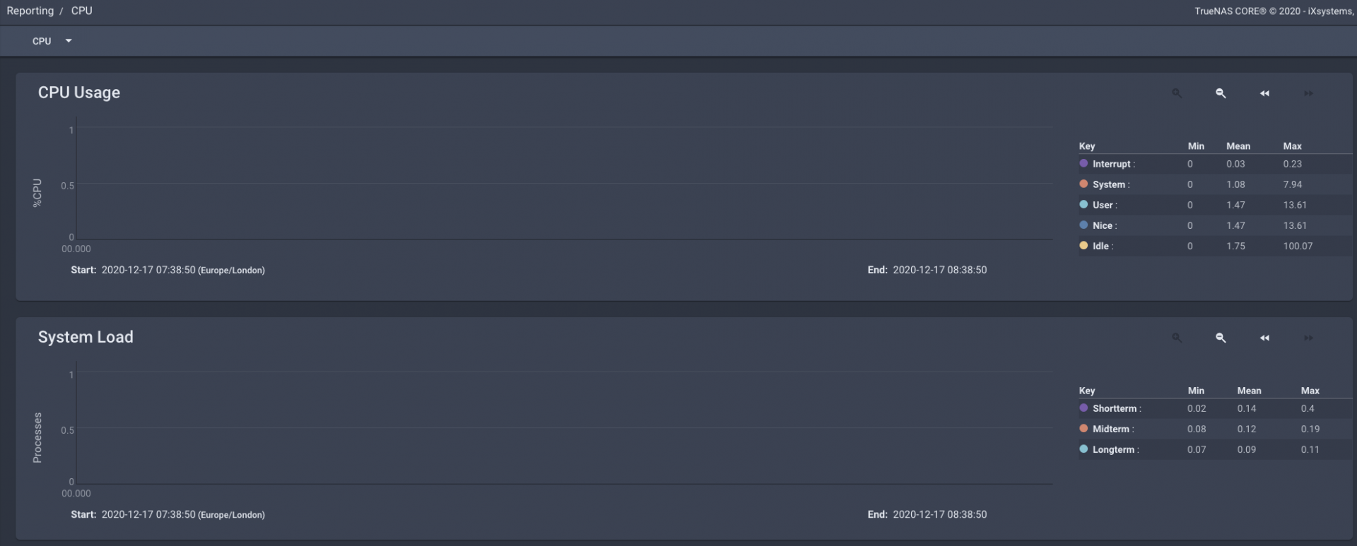

I have a new install of 12.0 that was then upgraded to -U1. It's on an Intel i5-10400 mini-ITX motherboard with 4GB of RAM (I have 32GB in the post). The install is on a 500GB M.2 NVME drive. And have a couple of issues... Some are probably just me not understanding how trueNAS works. But one has been mentioned a few times. Reporting graphs don't show any data. I get axes, legend, the lend shows current values, but the graphs themselves are not populated with data.
I've tried multiple themes. And haven't seen it change. Is this still a known issue in -U1? I saw a couple of posts about changing themes to fix it and then one that said -U1 might fix it. But it hasn't for me.

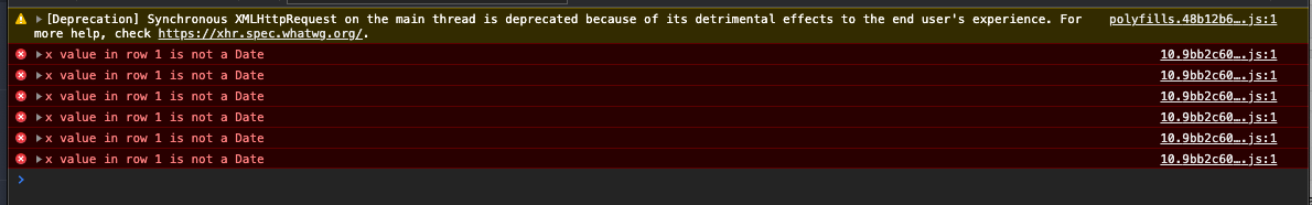

The current issue after 12.0-U1 is that data is displayed but no graphs are created and it seems to be tied to time zone. Los Angeled works but London does not.

Also in London. No graph lines appearing although after the U1 update, the horizontal lines indicating y-axis major values do appear.
