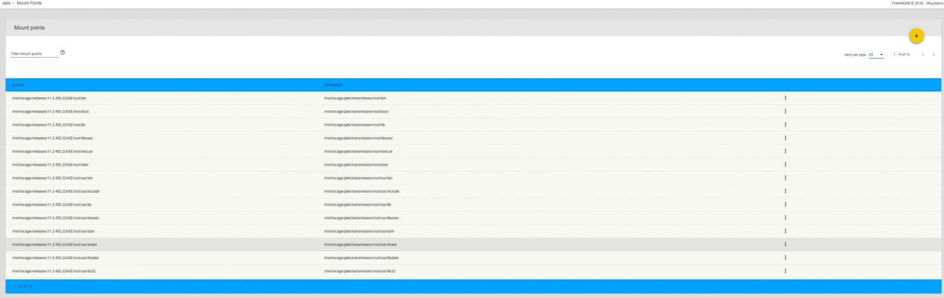

What do I need to enter at the Mount points under 11.2 Beta3 to source and destination if I would like to see and access my downloaded content at /Volume/Dataset/Transmission folder?
Thanks a lot.
Thanks a lot.
Ok, got it. Now need to find out how to grant access for the only user I have to be able to delete in this dir. Any idea?
