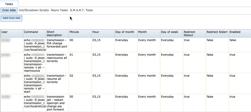

Here is how the cron jobs are setup.

If you can't put the task inside the jail crontab, you can at least have it run as the root user rather than as your own user and immediately using sudo.
This worked. I thought I tried running as root previously, but it didn't work. Now it is. Thanks!
