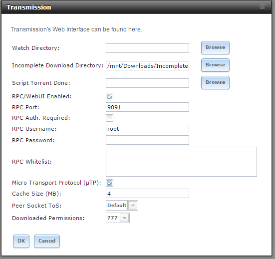

My problem is that transmission does not move the completed file out of the incomplete directory.
When I look at the Freenas GUI for transmission I see a GUI with the fields:
Watch Directory:
Incomplete Download Directory:
Script Torrent Done:

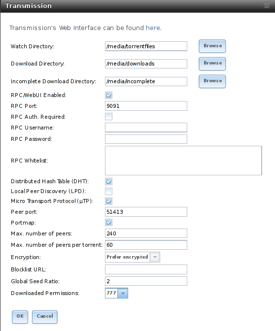

When I look at online guides I see a different GUI:
I've talked to my buddy who runs a similar setup, running the same version as I transmission-2.84_2-amd64 and he sees the same GUI as the online guide.
Does anyone have any idea what's wrong?

It's quite possible that the UI has changed since that guide was written..

As I pointed out my buddy is running exactly the same version of Freenas and tranmission as I am, and the UI on his server is identical to the guide...

Weird. Are you both using fresh plugin installations or has one been upgraded from an earlier version of FreeNAS?

His was upgraded from an earlier version, and we found a thread on the forum wherein the maintainer of the plugin wrote that he had deliberatly changed the GUI.
So I guess the case is solved.
The download to directory is set from within the Transmission GUI, and has been removed from the Freenas GUI to avoid overwriting settings.
