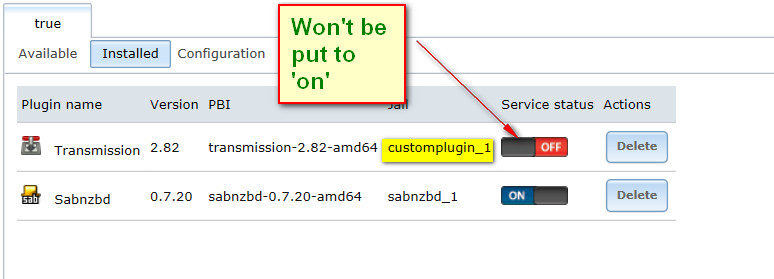

Well, I got something to work, but not that much.
Install via plugins/add doesn't work. It stalls at creating the jail (step 3 of 4) (it didn't ask me for which jail to use, btw: it's simply 'install? yes and then stalling at step 3).
(I made sure the jail is set to DHCP from my pfSense router. Didn't make any difference.)
(Also, 9 out of 10 times 'refresh' in the 'available plugins' shows nothing. One time, Snort even blocked the download server for a mall formed package).

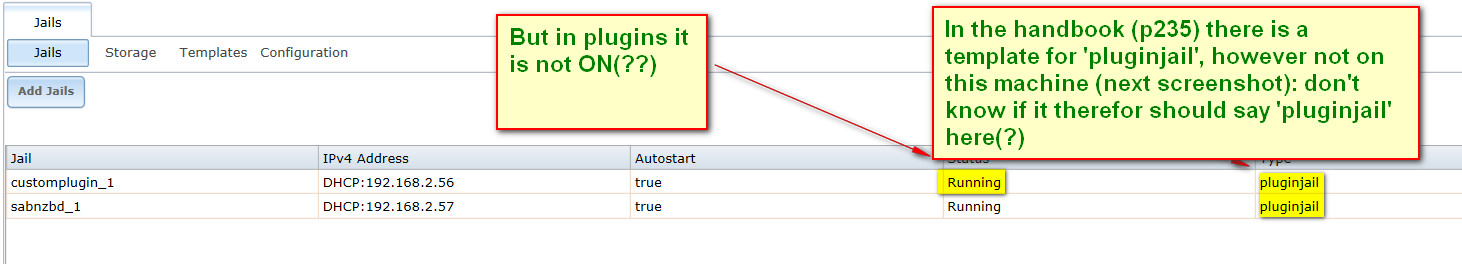

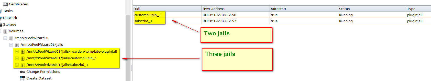

I then manually uploaded 2.84 (downloaded from download.freenas.org). Install took an age, however, it did install and created two(?) jails. It didn't start however, no matter how much I tried to put it to 'on'.
Five minutes later, it told me there was an update for it, so I pressed 'update'. Which appears to have rolled the 2.84 back to 2.82.

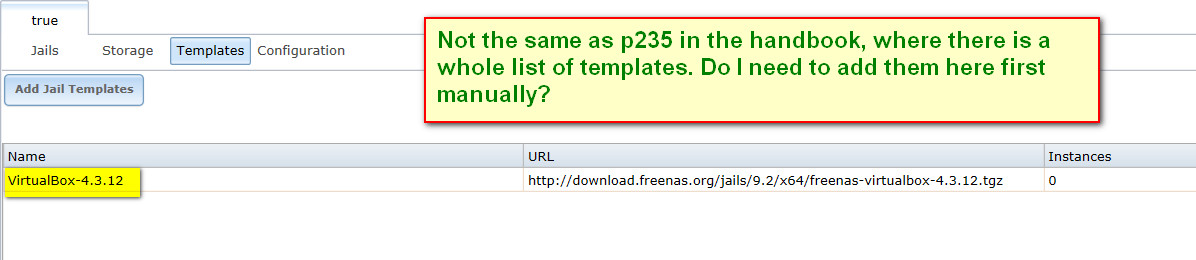

On snooping around and browsing through the manual, I noticed there are none but 1 jail templates. Could this have anything to do with it?
Also, in the manual is a text about adding storage to a jail, with Transmission as the example. Is this mandatory/can this be the cause of the problems?
Sabnzbd did install all at once, btw.

adding storage isnt necessary to get the plugin working so don't worry about it yet. the plugin jail template is hidden from the end user, but it is there.
not sure what your issue is. maybe delete all your plugins/jails from the FN webui, delete your jail dataset, recreate a new one and start from there. that's what I'd do, but im not sure if it'll work
