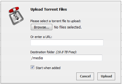

Ok, that seemed to work! Kinda.... When I go to add a new torrent I now get this:
No more "//Downloads" Yaaay

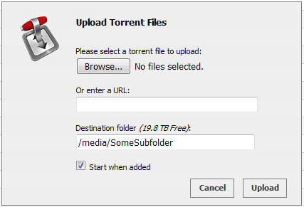

however, this doesn't seem to work at all:
Why can't I append a subfolder and have transmission download to that location?
Wallybanger
Apr 17, 2016
150
Actually, nevermind. That totally appears to be working now! Thanks SweetAndLow :)
