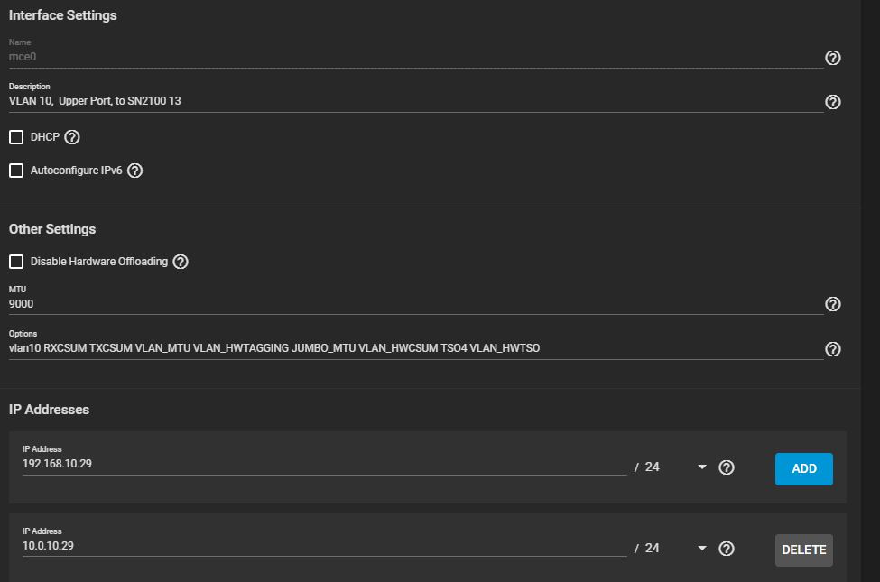

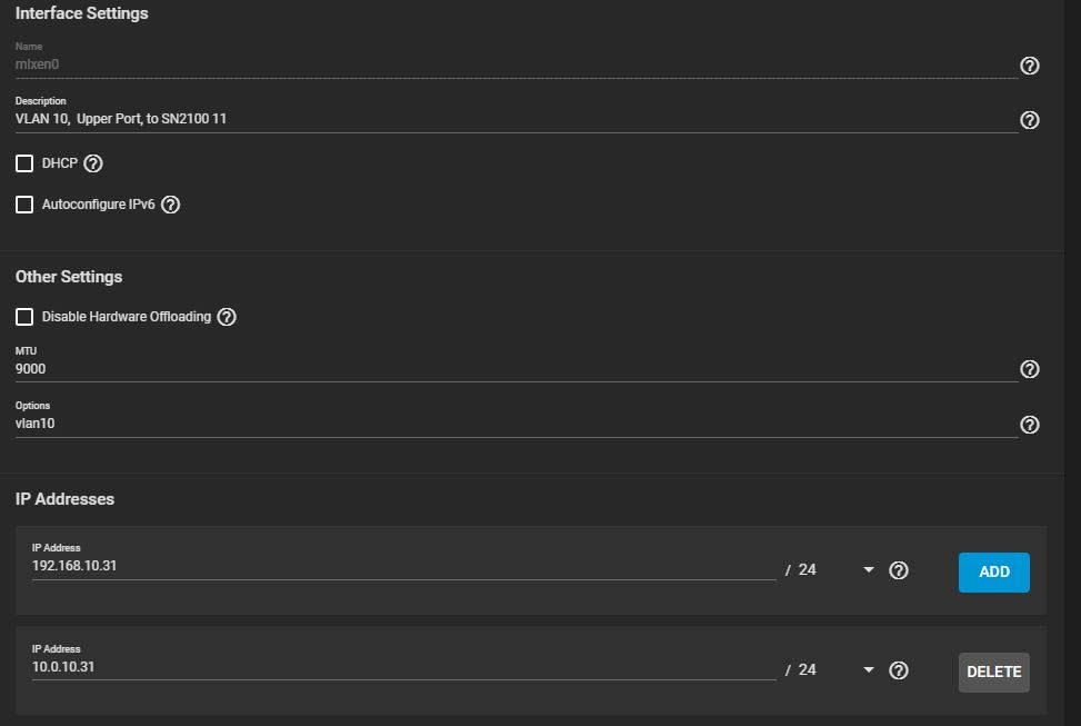

Edit2 - added config pics -tn13/ ip 31 is not working, fn11, ip29 is fine

Alright... realized that I had a physical x16 slot available (x8 electrical) so went ahead and tested some more
1- replaced the CX3Pro with a CX5... showed up in TN13, but could not link up.
2- reinstalled TN12 on the same box (with CX5) - link up at first try... ip, vlan, go. Working as expected
3- replaced the CX5 with the CX3Pro... acted up a bit, i think due to all interfaces having DHCP on automatically... sorted that out, ip, vlan, go. Working as expected.
So, conclusion - TN13 does not like Mellanox cards - in a sneaky, unfriendly way.

Ok, things are not as simple it seems...
Finished configuring the 12.8 box network, shares etc... tried mounting from esxi - not working...
Tried ping locally again ... not working...
Took me while but it turns out, as long as the secondary interface of the card is configured (presumably with another vlan) it wont work with the CX3Pro... configure just one interface with vlan... all good.
