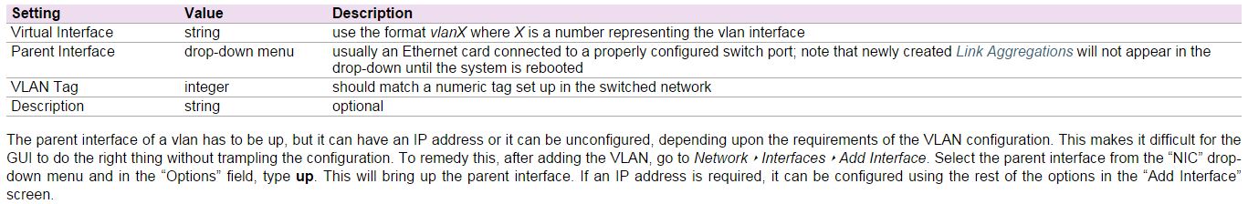

Add "up" to the options field of the interface you are vlan'ing.

though... i admit, i didn't follow the directions in the manual that Mlovelace just posted. maybe that was the issue. But it's working now so i'm not gonna bother.
