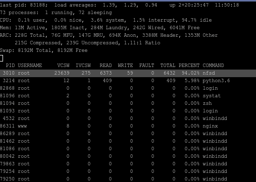

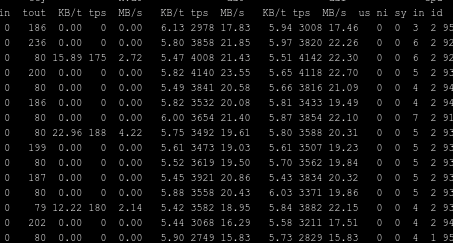

i have found something: running
top -m io -o total
and
iostat -w 1

Just because nfsd is responsible for almost 100% on your total IO does not make it a bottle neck. Look at your disks... Their only doing about 20MB/s... Look at the disk busy percent in the GUI. RAIDz2 is awful for random IO performance
kdragon75
Aug 7, 2016
2,457
Also when you take screenshots, including the column headers... I have not memorized the columns.
this is what i found 8 ssds with similar values
