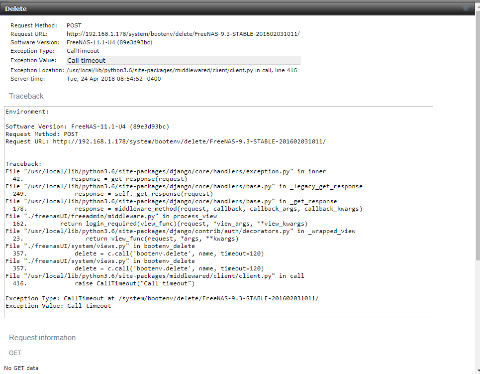

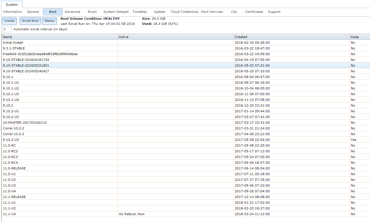

I am trying to delete some old boot environments and I'm not able to delete most of them (though I was able to delete a couple). I assume this is a bug that is reported and will be fixed? At some point my USB mirror will fill up and I don't want a future update to fail. These are mirrored 32 GB Sandisk USB sticks. Thanks.

Are those USB2 or 3? It might also be due to the mirror. If it is USB3, it might be worth reporting (though it may end up being that USB hardware sucks...)

These are 2.0 USB sticks in what should be 2.0 USB ports. I could try other USB ports, just in case, but I don't think that's what's going on.

Well, I proceeded to delete some of the boot environments that would delete. And then I was able to delete boot environments that had previously timed out (for instance Corral environments).
