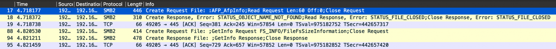

"the network backup disk does not support the required capabilities"
I have the same problem after the update to 11.3. A new installation doesn't help either.

nas# dns-sd -B _adisk._tcp.
Browsing for _adisk._tcp.
DATE: ---Fri 14 Feb 2020---
15:20:12.931  ...STARTING...
Timestamp     A/R    Flags  if Domain               Service Type         Instance Name
15:20:12.931  Add        2   1 local.               _adisk._tcp.         nas
nas# dns-sd -L nas _adisk._tcp.
Lookup nas._adisk._tcp..local
15:20:37.146  ...STARTING...
15:20:37.355  nas._adisk._tcp.local. can be reached at nas.local.:9 (interface 1)
 sys=waMa=0,adVF=0x100 dk0=adVN=nas_tm,adVF=0x82,adVU=6d69de9f-cff3-4feb-aedb-09d8319d3bce
would a tcpdump (port 445) be helpful?
THX
thedude123
Feb 13, 2020
4

I have found a solution for me:
macOS# sudo rm -f /etc/nsmb.conf
reboot
in my case (/etc/nsmb.conf):
[default]
signing_required=no
streams=yes
file_ids_off=yes
protocol_vers_map=2
before deleting (smbstatus -b):
PID     Username     Group        Machine                                   Protocol Version  Encryption           Signing
13512   marius       XXX       192.168.1.99 (ipv4:192.168.1.99:50393)    SMB2_10           -                    -
after:
13626   marius       XXX       192.168.1.99 (ipv4:192.168.1.99:50403)    SMB3_02           -                    partial(AES-128-CMAC)
Time Machine works like a charm. :)
