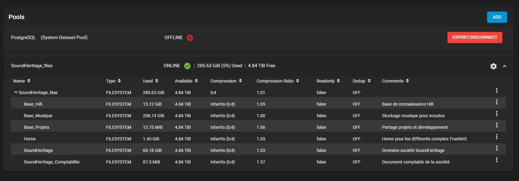

You can see, the system is online, without the System data pool. (there was only one ssd hard disk for this pool, probably an error)

Just move the system dataset (pool) to the other pool. You don't need the data in the system dataset - its mostly reporting and such
Or move it to the boot-pool if the boot pool is SSD and mirrored
If you are AD connected you will probably need to disable AD on a temporary basis.

Sorry for the post before. So i just export/disconnect system data set pool with export disconnect button. The system data set pool was transfered to SoundHeritage_Nas automaticaly. A reboot, and that's fine. All the sharing was again online, with the good sharing permision. So thank you for your answer.
I will add a secondary disk for the boot-pool (only one), because it was fail too !!! But a copy was donne successfully by chance. There will secure the TrueNas boot system.
