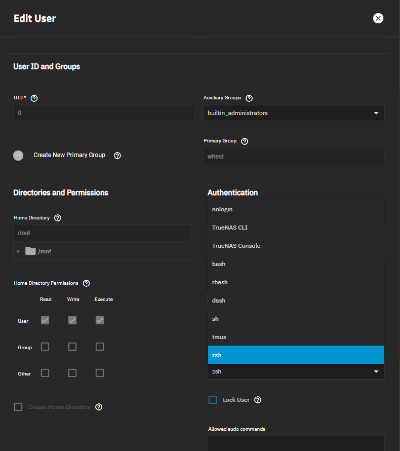

solved. here is the fix
It seems like your shell for the admin user is defaulting to the TrueNAS CLI rather than zsh - you can change this under Credentials -> Edit User.

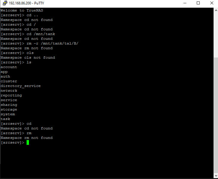

I noticed there is an error in putty on login mentioning /nonexistent
which I recall is used for home directory.
I went ahead and created a home directory. this prevented the error on login in putty.
but it did not resolve the issue.
I am still unable to use cd or rm. sudo does not exist either.
ls exists and is showing... something.
I have no idea what it means though.
attached is the picture showing the exact errors

NugentS
Apr 16, 2020
2,947
You are in the wrong place. You are in the CLI rather than the shell
taltamir
Aug 2, 2022
28
Thank you for the help.
Truenas says I am in the shell, as per attached image.
TrueNas might be using the wrong term there...
Well, How do I make it so that putty goes into shell instead of a shell-less CLI?
NugentS
Apr 16, 2020
2,947
Dunno why its going into the CLI in the first place. Shouldn't be happening
taltamir
Aug 2, 2022
28
that is weird...
I have a thought.
originally I created this server way back when I scale was still in beta and I was forced to login as root via the web gui.
about a month ago I enabled the ability to login to the web gui via a named user account (with admin privilages) and disabled the ability to login as root.
Could this have caused this issue maybe?
or am I barking up the wrong tree?
