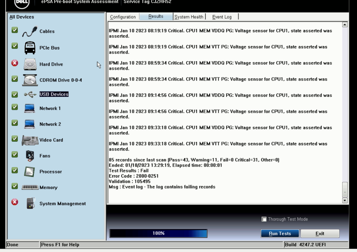

Also, those CPU voltage warnings don't look great...
