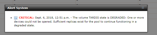

Hi
I have had a problem now for a little while with the critial light flashing telling me
CRITICAL: Sept. 6, 2018, 12:51 p.m. - The volume TARDIS state is DEGRADED: One or more devices could not be opened. Sufficient replicas exist for the pool to continue functioning in a degraded state.

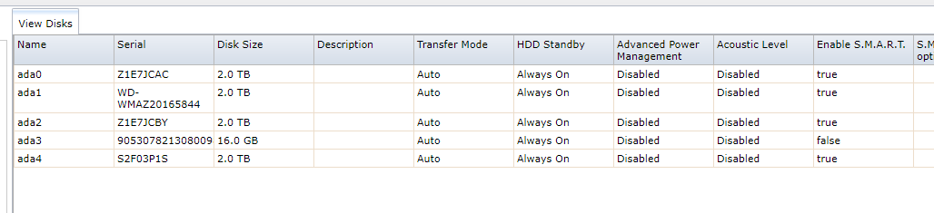

I got to Storage>Volumes>View disks and it shows my ada3 16GB SSD drive sitting there which is the boot device

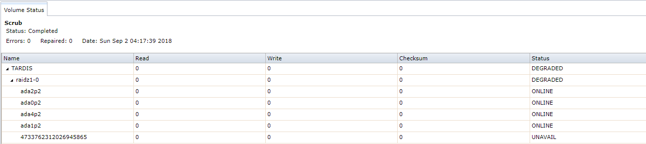

I go to Volume Status there is no ada3 instead what I guess is the boot volume shown as unavailable

This has nothing to do with your boot device. As per the image you posted, one of your drives in your raidz1 vdev is unavailable. This has put your entire pool in a really bad state. One more drive failure and you will loose the pool. You need to replace the failed drive immediately. Power off the system until you have a replacement drive burned in and ready to resilver.

My issue is then identifying the culprit. as from above you can see there is no ada3 (ada3 as far as I know sits as boot drive).
this shows the boot drive as ada 3 - and the critical alert system is not advising the actual disk that is in error - just that the state is degraded.
can you see what I mean? As far as I can see the only clue is that the image in the previous post shows no ada3 but numbers for the name and the status of unavail. ?

You have four 2 TB drives in that picture, but your RAIDZ1 vdev consists of five drives. Just match the serial numbers with the drives in your machine.

I followed the instructions: I got under the hood, wrote down all the serial numbers of the drives I had physically in there. Looking through the GUI, I matched up the serial numbers all bar 1 - that was the culprit - I replaced it and now we are back to healthy and Resilvering.
