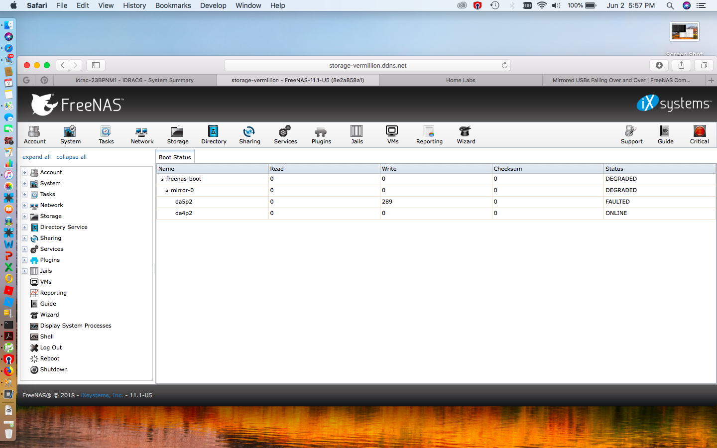

first set of usb lasted about 3 weeks, went out and bought 2 new Sandisk Cruzers today, put them in rear ports, and no less than 4 hours later, I have a critical warning of a degraded drive...what can be causing this?
CRITICAL: June 2, 2018, 4:52 p.m. - The boot volume state is DEGRADED: One or more devices are faulted in response to persistent errors. Sufficient replicas exist for the pool to continue functioning in a degraded state.
any advice?

The answer is crap USB drives. Unless you have your system dataset on your boot pool, in which case the solution is to move it to the main pool.

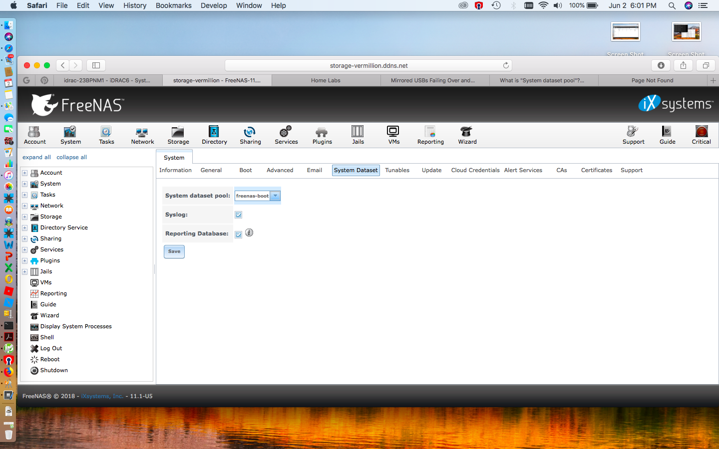

If not already done move the system dataset from freenas-boot to a (or "the") data pool.
http://doc.freenas.org/11/system.html#system-dataset
If nothing else helps use (a) better boot medium/media. SSD instead of USB flash drive.

cant seem to find much documentation on this, why is this causing an issue with new USBs?

Ok I have moved the system dataset to the zfs volume....now just reboot?
AFAIR yes. BTW: The system dataset of a FreeNAS 11.1 system used as a basic filer (no jails, plugins, VMs) typically causes more than 100 GBytes writes per month / more than 1 TByte writes per year. To be compared with durability of flash drives ...

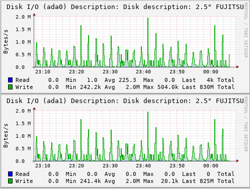

It causes constant activity to the storage pool. Look at this:
My NAS is completely idle. Everyone in the house is sleeping (except me) and I am not using it, but the system dataset is constantly hammering the drives. I use regular hard drives for my boot pool, so I put my system dataset on the boot pool on purpose. The advantage for me is that it allows my storage drives to be idle and saves some wear on those drives. If you have this kind of activity on a USB memory stick, it will kill it in no time at all.
