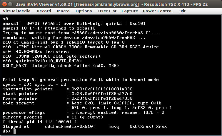

Even stranger: I just attempted to boot into the installer (ISO, mounted virtually via IPMI). This is the same ISO image I used to install yesterday, and installation ran without issue. The SHA256sum was just confirmed a few minutes ago. Here's the result now:
Time to burn it to a USB and boot from that, I guess.

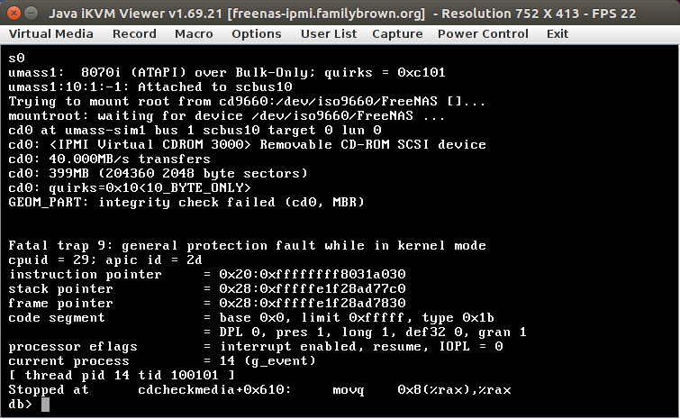

At this rate, by Tuesday, @anodos (next most liked guy after me and @danb35 ) will suffer a mysterious failure on a server of his that leads into more WTF events.
I propose we all pitch in and hire an exorcist. I know a guy.
15,504
Burned to a USB stick, that didn't even show up as a bootable device. Downloaded the ISO and sha256 again, verified the sha256 (it was fine), and this time the installer booted and ran without apparent error. The new install is booting now, whereupon I'll upload the config (copy taken right at midnight, so before whatever happened, happened) and see what happens.
Edit: Who knows, we might need the exorcist yet.

It might be worthwhile to check the event logs in IPMI for any sort of hardware fault detected. Maybe run memtest as well.
15,504
Good idea on the IPMI logs, I hadn't thought of that. Nothing in them, though, except for chassis intrusion when I had the case open a few times. I'd run memtest for a few days last week when I got the server with no errors found (it is ECC RAM, which should make this a non-issue, though I'm awaiting @cyberjock's analysis of the faulty ECC stick he received).
