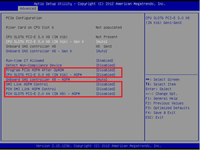

About the PCIe ASPM BIOS settings (in Advanced > Chipset Configuration > System Agent (SA) Configuration > PCIe Configuration) - refer to attachment. This is what Supermicro recommended I try. Note: I kept the 'Onboard SAS controller X8 - ASPM ' because I'm actually using the SAS controller.
At this stage I'm waiting for some feedback on disabling PCIe ASPM in the kernel.
