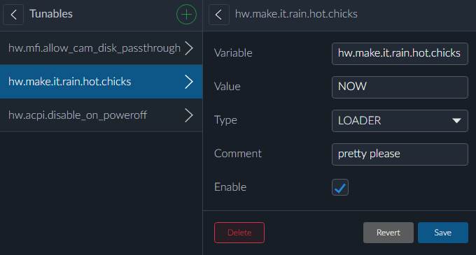

Hmm interesting.
Because I managed to add it successfully (and there is some sort of validation done before committing), I didn't go any further to find it e.g. using sysctl.
See attachment.
styno
Apr 11, 2016
466
Are you still sure there is validation? :D
(Or is this lack of validation a bug in Corral?)
kyp
Jan 24, 2016
58
Haha, interesting.

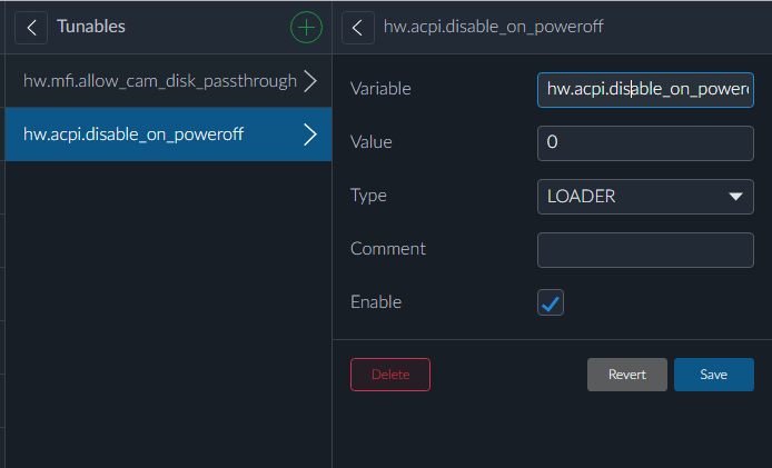

Must be some very crude validation then coz if you try variable "a.a" with value "0", then validation fails.
Not sure now if "hw.acpi.disable_on_poweroff" is legit - it's not like I invented it lol, it was in the FreeBSD handbook! - and FreeNAS is based on FreeBSD.
Maybe the folks in the FreeBSD forum can shed some light.

Hey guys, this might be a solution.
This is directly from the FreeBSD handbook: http://www.pl.freebsd.org/doc/handbook/acpi-debug.html
11.13.2.5. System Powers Up After Suspend or Shutdown
First, try setting hw.acpi.disable_on_poweroff="0" in /boot/loader.conf.
That copy of the FreeBSD Handbook is from 2007 and covers FreeBSD 6.2. The setting does not exist in FreeBSD 11. Even that chapter of the Handbook is gone.
There are some current entries that might have similar functionality:
hw.acpi.handle_reboot: 1
hw.acpi.disable_on_reboot: 0
However, I suspect that ACPI on FreeBSD has come a long way in the last ten years. It would be worth checking that the BIOS on the system is the most recent version, as ACPI bugs are sometimes fixed.
