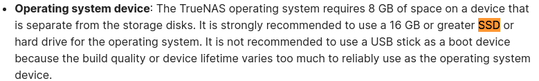

I used to get railed on these forums talking about using real boot devices.
Why when TrueNAS came into the picture did the requirement change:
Kris Moore
SVP of Engineering
Administrator
Nov 12, 2015
1,471
We've been trying to encourage folks to use real boot media for a while now, even before TrueNAS 12. USB media is just too sporadic to recommend across the board, and there are issues with some chipsets where it just doesn't play nice with FreeBSD well enough. Obviously folks can use what they want, but our recommendations need to be for the things that will work the *most* reliably all the time.

Well then I guess the real question I am asking is that, is TrueNAS targeted now, and in the future to be booted from USB?
I remember all the logging was done on the ZFS pool you add, and not rootfs....
Is the rootfs pool still meant to be read only?
Since you removed the USB requirement, don't you predict a shift in what the rootfs pool will be used for?
We haven't recommended USB for well over half a decade, since before you signed up for these forums.
Nothing in what you quoted makes USB look like a desirable option, either, so where exactly are you getting that from?

I believe it was version 9.3 when the boot pool became ZFS which exacerbated the issues with lower-quality USB sticks. With that said I've used (decent quality) USB sticks to boot from on low-traffic "family backup" systems.
The installer still says "flash media" because it's important to differentiate between "USB the protocol/method of attaching drive" and "USB the cheap flash drive for $2.99 at the corner store" - a used Intel SSD (or even an HDD) attached via a USB to SATA converter is a fine option, provided you can secure it properly.
The cheap thumbdrive on the other hand may fail after a short period of time and cause you to wonder why you're getting middleware errors or a non-responsive system, and ultimately iX doesn't want to have systems in the wild that are giving a bad impression of software based on hardware that's misbehaving.
