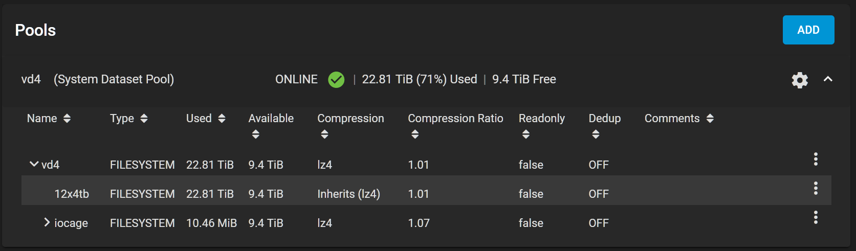

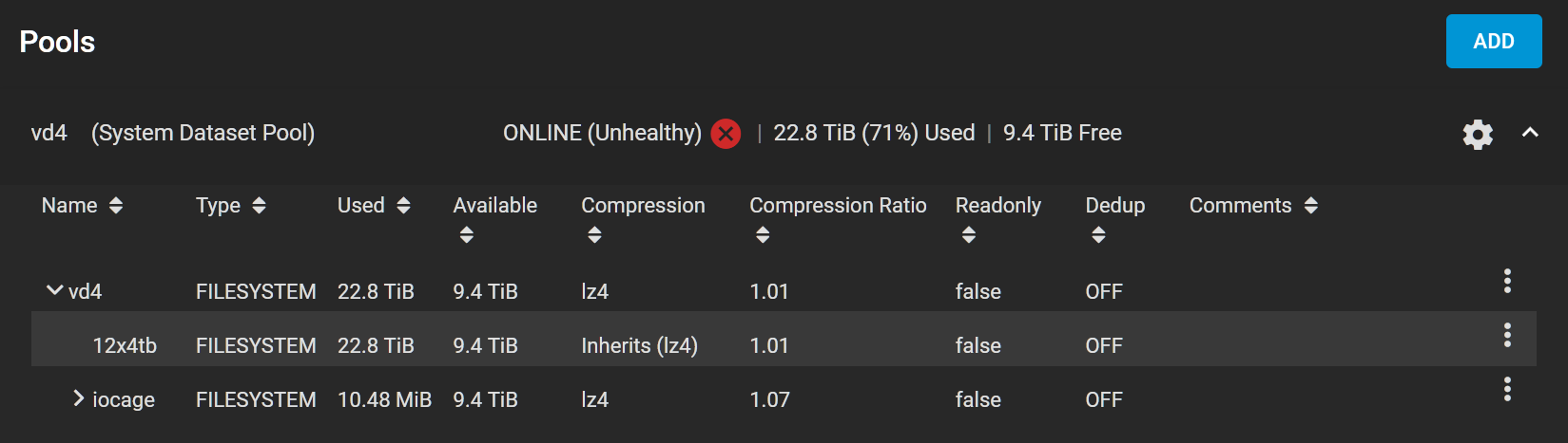

Hi sretella. Thank you for your fast response.
Yes, the pool is still available. It's a little strange, as before I saw it in Unhealthy state, and after reboot it's saying Online and healthy again. (I will attach the screenshots).
Here is the zpool status -v:
