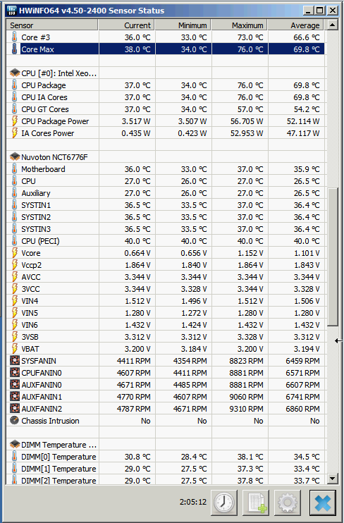

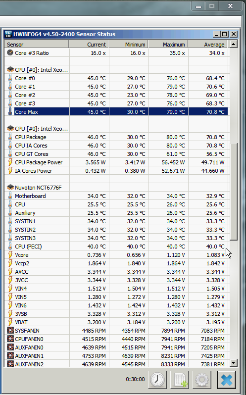

Anyways I am saying supermicro is better. I can even find some testing screenshot I keep from my tests.:smile:
On the first pic I let it run for 30min then stop it when it reached 79 C , but second one with supermicro I let run for 2 hours and never got above 76 C.
