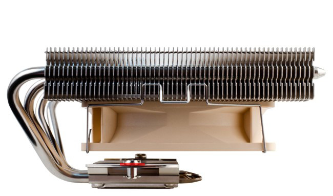

The Intel cooler works absolutely fine and quiet for the cpu.
I am not as happy regarding the sas-controller though - it gets hot to the touch idling with 1 disk attached.
Honestly I would stay away from tower coolers since they direct even less airflow towards it than the stock cooler.
I have a top-blow-cooler in the mail (Noctua NH-L12), I will post the results.
Ok, that did not work at all ;)
Actually the sas-controller got even hotter than with the stock cooler, I think.
The problem is that the Noctua fans go to super low speeds where they basically do not move any air.
Couple that with the pretty much non-existent fan-speed settings of the Supermicro boards and that concept does not work in itself.
However I used the included 92mm fan to blow some air directly onto the sas-controller which seems to lower temperatures to semi-reasonable regions.
Other notes:
- I really like the cooler in itself, great build quality and very capable for its size and weight.
- The cooler does not get properly pressed onto the cpu in its stock configuration.
In fact it just 'dangled' on there, thank god I noticed that.
In the attached picture you can see a red stripe, where I had to insert a washer.
- Configuring ipmi to accept the low fan speeds was a major pain for a FreeBSD novice like me.

Not to bash you, or argue with you, but Noctua is very well known for quality products. If it was dangling there then I'd say either a piece is missing(or lost), or user error is playing a part. As we all know(and you obviously know) the heatsink is supposed to be applied with pressure onto the CPU heatspreader. I'd go looking for pictures of the cooler to see if maybe you are missing a piece.
indy
Dec 28, 2013
287
User error is of course a likely suspect ;)
However I could not find any installation error, there are not many 'adjustable' parts determining the distance between cpu and cooler anyway.
Just double-check your installation if you choose to install this particular cooler.

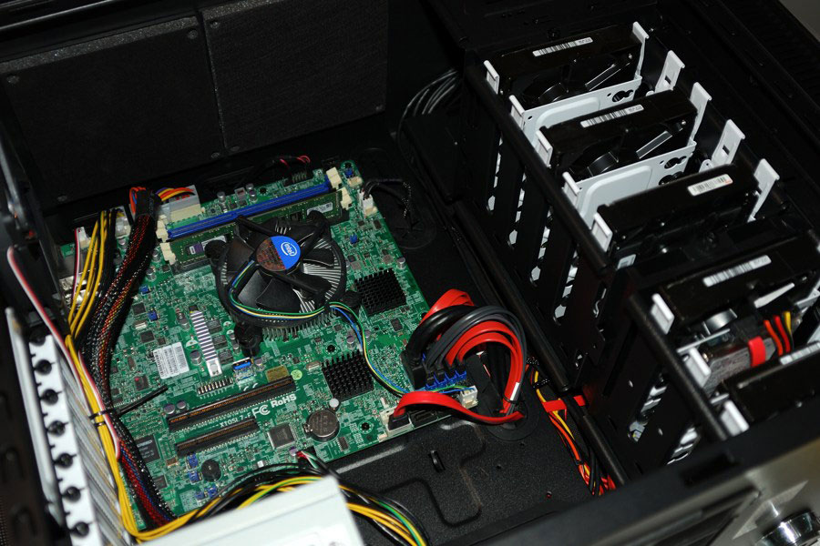

Finaly got first stage of building my home server finished: Supermicro X10SL7, Xeon 1230v3, 8GB Kingston KVR16E11/8, Fractal Design Define R4.
Now testing it with seven 500GB drives in raidz3 mode (had them anyway).
Future second stage - buying HDDs and appropriate amount of RAM for them.
