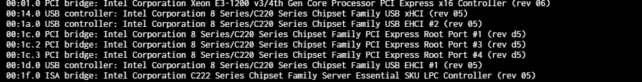

I'm running truenas scale on an old SM x10sl7-f with a win 10 and home assistant as vm:s. i'm having trouble figuring out how to pass through usb controllers to different vm:s. (as i understand it single usb devises cant be pass troughed, yet).
In truenas i can see 3 different usb-pci controllers but only one of them seem to actually pass through anything. ive tried to pass the differnt usb-pci controllers to the win 10 vm and then tested all the ports but only one (00:14.0) seem to do anything and control all usbports. right now my problem is that home assistant have "all" usb ports and that aint good cause truenas hasn't any and cant communicate with ups.
do anybody have any idea. is this a SM kink or am i (most likely) missing something.
any help/input would be appreciated.
thank you /Micke
