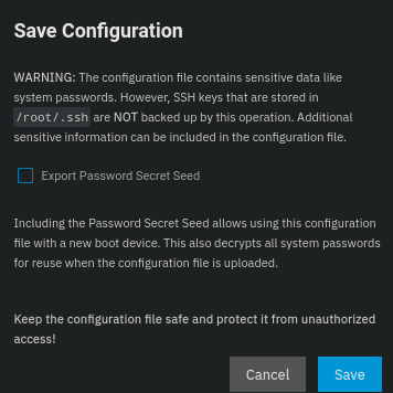

I just backed up the data backup from System Settings > General > Manage Configuration > Download File to a private repo on GitLab. Could this be a job, which is run by TrueNAS on a daily basis?

Does the file from /var/db/system contain the password secret seed?
