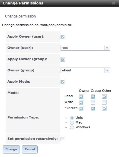

What are the permissions on the dataset? By default it should be owner root, group wheel, permissions 755. If so your script should work.
nojohnny101
Dec 3, 2015
1,477
hey @KevinM
yep my dataset permissions are exactly like your screenshot. no problem there.
