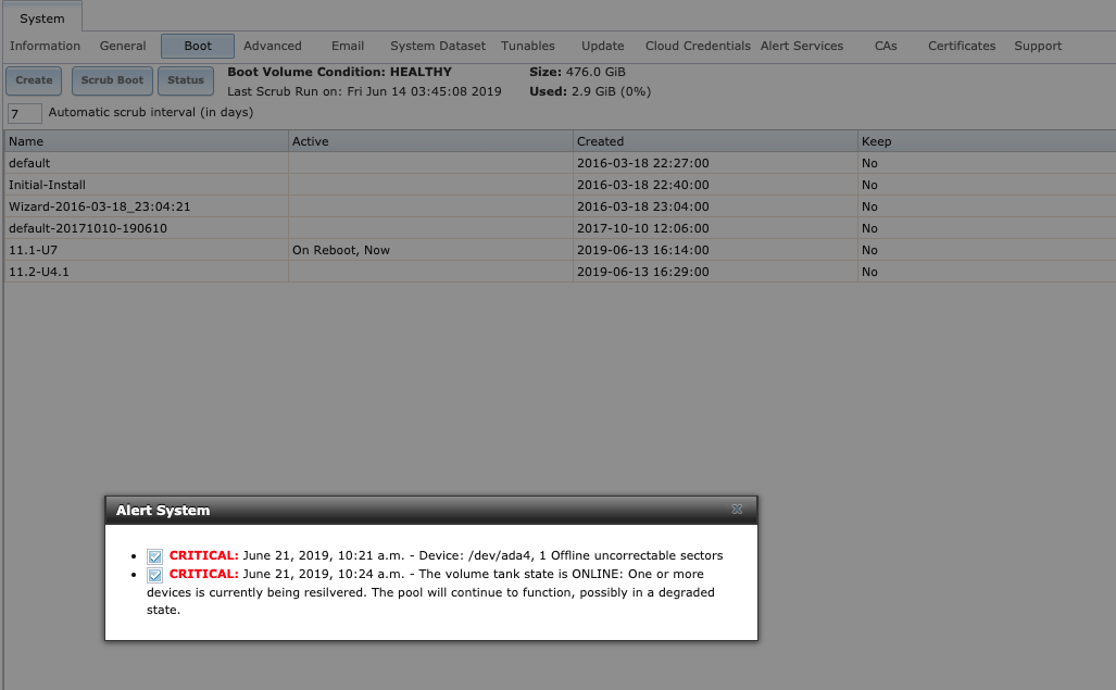

Hello everyone! We are still looking for help on this if any of you have any ideas. We have replaced one of the disk with errors but still not able to mount AFP shares. There is another disk (looks to be the boot disk) that shows as healthy but has "offline uncorrectable sectors". We are going to be adding a USB soon that will be mirrored and used as the primary boot disk once it's ready. Don't understand why the volume condition shows as healthy when it has errors though.
