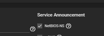

In services / SMB, "netbios name" is still set to "fsfs". But the system hostname says "freenas".

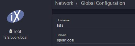

network / Global Configuration / hostname is still set to "fsfs".

It seems to be some kind of change to the handling of the domain field in network / global configuration. And I haven't found a way around it yet.
All along, I've had hostname "fsfs" and domain "bpoly.local" set. All my local systems have bpoly.local as the default domain, so as a result on any local system I can address the FreeNAS box just as 'fsfs' and it'll reach it.
This has changed. Now, when I put that in, while it shows the right domain name 'fsfs.bpoly.local' at the top of the left GUI column, I can't access the server (via mount, ssh, or ping) as just 'fsfs'. I also can't access it as 'fsfs.bpoly.local'.

At this moment the server is configured as hostname 'fsfs' domain 'bpoly.local'
