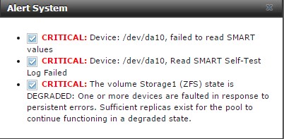

Should I just restart my server and see if it doesn't clear up?
Nope, need to replace that drive. Be glad that you are running RaidZ2 since you can withstand 2 drive failures in your vdev. But I would not suggest waiting around on getting a replacement drive in there.

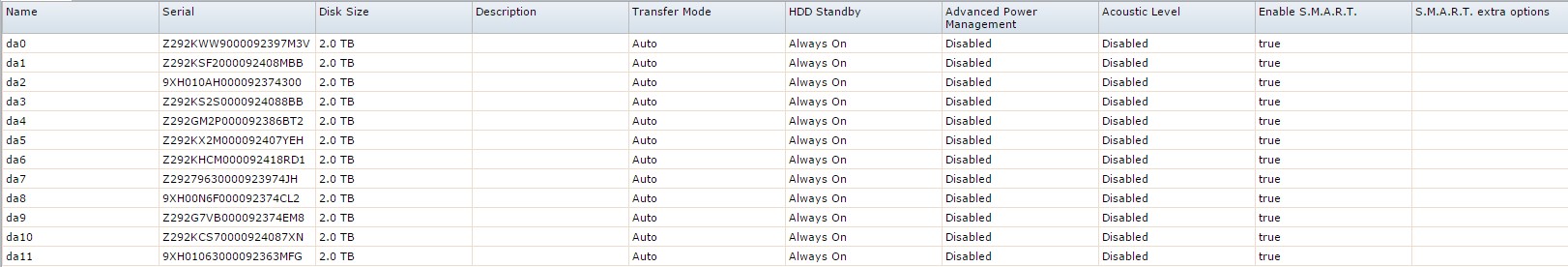

How do I know what drive needs to be replaced?
  1. Look under [Storage] - [Volume Status] to see which drive has failed
  2. Obtain the Serial Number from [Storage] - [View Disks], then match it to the failed drive in your system. Most of us here already keep track of the drive serial numbers and their physical locations just in case of an event like this.

Do you also have it configured to monitor drive temperatures?
No, I don't know how, and I don't know what the other options are either (APM, A. level, etc.)
However, it shouldn't be overheating at all, this server is in a cement basement. The temperature down there in the winter is around 45 - 50 degrees.
During summer, the a/c keeps the temperature around 55 - 65. I keep the unit clean and dust free as well.
You configure temperature reporting under "services" -> "S.M.A.R.T.". FYI, the webgui errors you have above should have spammed your email inbox. This is a good chance to make sure that your email reporting worked properly. :D

The webgui errors you have above should have spammed your email inbox.
I was on the server last night (I check it manually about twice a week) and there was no issues.
As of 10 AM CST this morning, I had two or three emails from the server, one of which I couldn't post here because it was over the 30k character limit.
Configure temperature reporting under "services" -> "S.M.A.R.T."
Thank you, I set it at 32 / 35.
