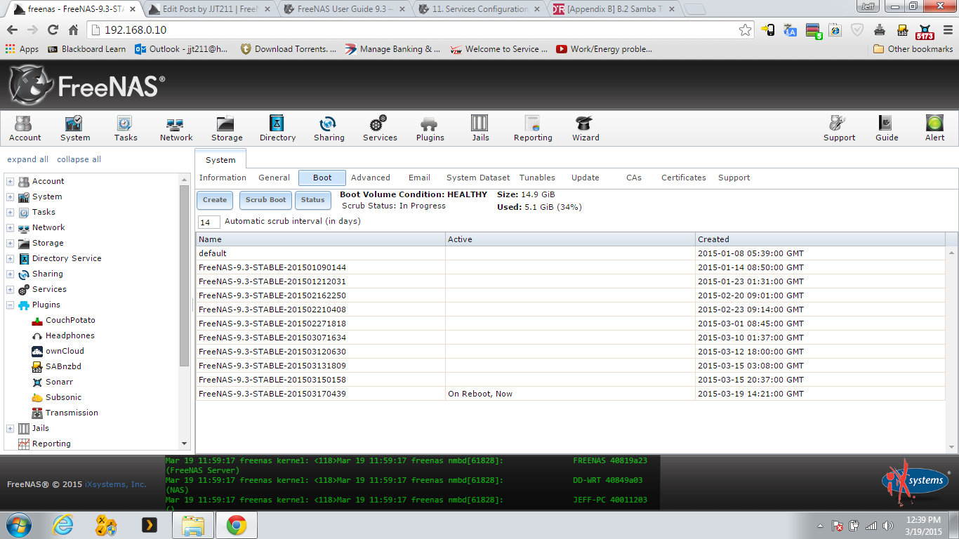

Set them up the usual way - GUI -> Shares -> set preferences
Only change I made was unchecking the hostnames lookups as suggested by a friend of mine. I'll attach a screen of the CIFS settings...
