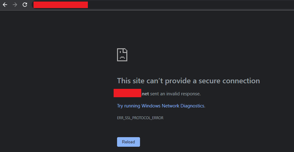

I have been working on setting up SSL so that I can connect to my server externally, securely. I believe have everything setup in my routers correctly for forwarding traffic to my TrueNas server as I get a response. When using my domain URL to contact the server I get the following:

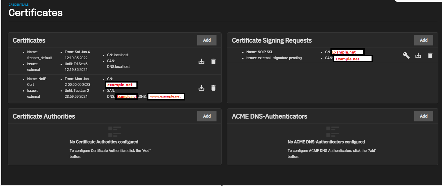

This leads me to believe there is a config error. I created a CSR which I used to get a CA Certificate from my provider. I have installed the CA on my system. However I noticed that on my Certificates page that my CSR is still in "Signature Pending". Could this be my issue ? If so how would I go about resolving it ?
My certs page looks as below: (I have obfuscated my domain, but used the same layout as my actual domain)

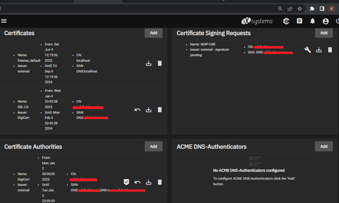

So I resolved the problem in my last post. I was able to get the Certificate Authority sorted.
I have used the Certificate Authority to create my certificate by clicking on the "Sign CSR" button. I now have (to my knowledge) everything setup so far as the certificate chain. Oddly for some reason the CSR still shows as "Signing Pending", not sure if that is an issue. My setup is below.

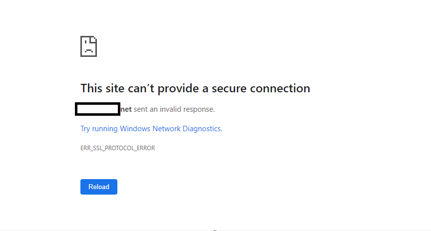

When I set the GUI to use my new certificate, I get the following errors if using HTTPS/IP or if using my domain. Please see below. I feel I'm close, but something is clearly wrong .
Any ideas ?
