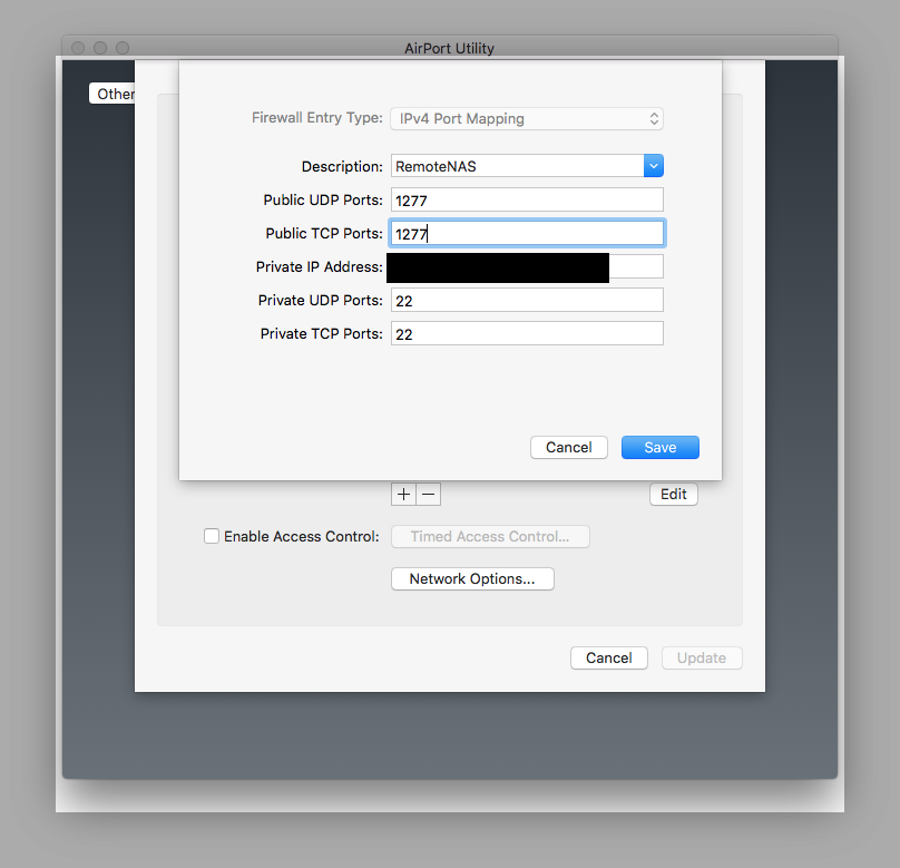

this is what my router settings are:
also i thought since i was connecting internally, it wouldn't matter and i shouldn't have to be going through the external facing port of 1277?

It says port mapping which is a strange description. Is there one that says port forwarding?
nojohnny101
Dec 3, 2015
1,478
hello,
that is the only option for the apple airport extreme and after doing some research on the internet, it seems "port mapping" is the same as "port forwarding" in apple terms, strange i know but i don't think that is the problem.
