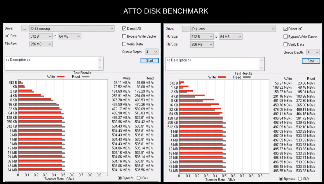

Thanks @HoneyBadger, @MrGuvernment for the input. I spent way more time on this than I wanted to, but for what it's worth I decided to get a pair of Lexar LNS100-256RB. It will likely take me a day or two to open one and give it a check. I'll keep an eye out over the Black Friday/Cyber Monday and if something better comes along I can still take them back if I haven't opened the boxes.
Any way to "benchmark" on TrueNAS? Failing that what about Linux? It seems most of the fancy benchmark stuff is aimed at Windows.
