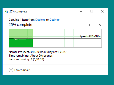

My write are no better then with my 12x 4tb ironwolf's. My reads via SMB from freenas to desktop are 950MB/S +, but writes are still 550ish. And NFS read/write (without slog) are 550MB/s read - 650MB/s write. - With slog it goes to 850MB/s write, but still 550ish read.
Are my expectations unreasonable with this setup? Is my hardware not capable? A configuration error on my side? Tried with/without autotune - tried with jump packets all the way through)
Iperf numbers are good all which ways. Desktop has X550-T and using stripped nvme and a OCZ Z Drive for copy to/from. (Benc mark 2.86GB/s Read & Write)

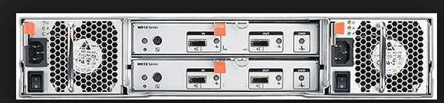

With the external 16e hba - Have a better model in mind?
Ok - So for mirrored vdev's - suggestions? - 2 drives in mirrored vdev? or 2 raidz2 mirriroed vdev? -
I'll have to play with freenas as the GUI is a little confusing as to what I want to create.. it seems like it would take a little while doing 2 drive mirrored vdevv..
zpool create tank mirror sda sdb mirror sdc sdd mirror sde sdf mirror sdg sdh mirror sdi sdj mirror sdk sdl .. etc? - But that doesn't give me so good redundancy does it?
Chris Moore
May 2, 2015
10,079
External: LSI 9201-16e
The one you have uses PCI-E 2.0, so you could go to a newer card that uses PCI-E 3.0 but I am not sure that is going to be a significant change for you. You might look at this, which is a newer chipset, with is PCI-E 3.0 , but I don't know if that is a guarantee of better performance.
https://www.ebay.com/itm/LSI-9206-16e-6Gbps-SAS-HBA-P20-IT-mode-firmware-ZFS-FreeNAS-unRAID-Dell-TFJRW/163274936627
The bad part is that it takes a different cable from the card to the disk shelf vs the one you have now.

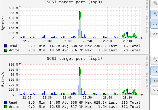

I'm starting to second guess my testing methods - First is I create an NFS share off the pool, using vcenter create a windows 2019 server image, install vmtools and then use Atto Disk benchmark against c drive (since its actually sitting on the freenas pool)
12x vdev (no slog) 750MB/s write - 550MB/s read - Assuming via esxi this is a sync write via NFS
24x Vdev (no slog) 650MB/s write - 450MB/s read- NFS (I created new VM to see that it spread the files across more of vdevs)
I know adding a slot will help max my write, but not my read. - I'm a bit baffled as I can get same performance with my 12x spinners with slot. I just don't have the heart to sell these JBOD trays - I need to find a problem to my solution! lol

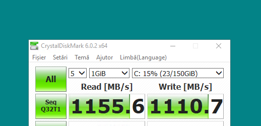

Now, I did some SMB tests (confirmed desktop to desktop hits 1GB synchronous (Nvme to Nvme) )- Now from desktop to Freenas SMB folder - With 24x Vdev-580MB/s write & 950MB/s read
I'm curious if my testing methods are SH** - Considering my numbers - Raid2z is almost comparable but I pick up a few more TB with it.

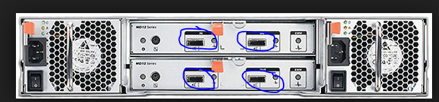

With your setup, i would definitely use separate controller for each shelf. I do the same, in your case that would be 3 card's / shelf or 1 x 16 port / shelf ( LSI SAS 9206-16e )

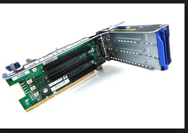

Also, do you have both raiser card's in the system? Guessing not, since you have only 1 cpu, but check
The drive's you have are 500 read and 460 write, so you should go past 1000mb/sec in any raid setup ( 10, z1, z2, z3 )
the picture below is with only 2 samsung qvo ssd 1 tb in mirror ( I have 8 vm's running from he same pool when doing the copy test )
Right only 1x CPU - as this is storage only - I figured higher clock and lower core's[/QUOTE][/QUOTE]

On full SSD, i remember that SLOG or ARC is not needed, as 48 SSD's will outperform 1 NVME ( in generaly )
I would go with a better HBA, as I sad, for me it worked, and as i posted above, i get 335 MB with 1 mirror of SSD, not with 24 ( 48 / 2 ).
Also do note, thet you will hit more than 75.000 iops with a raid 10 setup from thoe's 48 SSD's, that meanes that you'r vm's will work almost instant.
I am sure that your problem is something related to HBA.

If you want to put another RAISER in that HP, you will need to install the other CPU, as the 2'd raiser uses PCE-EX lanes from the second CPU.

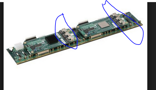

As for the shelf's, I am not familiar with SUPERMICRO, so my statement in my previsius post may be off regarding the number of controllers needed for 1 shelf, as i saw the backplane, it has 6 sff 8087 connectors. Is that true? or it uses SAS controllers as HP, DELL or NetApp?
If this is your case, you could use a SAS EXPANDER, like the Intel RES2SV240 SAS 2 Expander ( https://www.servethehome.com/byo-sas-expander-deal-intel-res2sv240-sas-2-expander/ )
Supermicro:
Dell:
