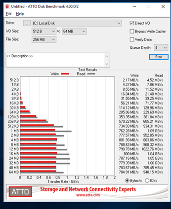

So - Here is where I am - I keep getting the same numbers no mater what hardware I've thrown at it. (24port to 1 expander gave similar numbers)
This is with 12vdev - Mirrored Intel s3700 (24x drives) - My raid2z had similar numbers. This has 3x SAS3 controllers - so card ONLY has 8x SSD drives per controller. I've put some heft behind it with dual E5-2690 V2 and 256GB ram.... I thought for SURE this would fix any NFS speed issues. I can throw an optane SLOG and it helps with performance numbers - but everything I see - with this setup I should EASILY max my 10gb EVEN with sync-enabled.

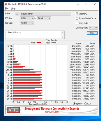

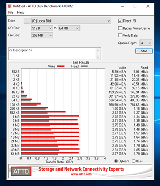

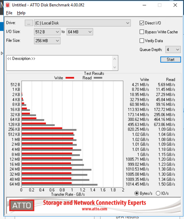

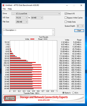

Rebuilt an ESXI host and that seems to have improved my performance.. There may have been some sort of issue with NFS 3 and NFS4.1 on freenas box. (I took a hunch and enabled, rebooted, disabled, rebooted, enabled 4.1, rebooted)
I would've thought that with 12vdev mirrored SSD I would have pegged write speeds..
With an Optane SLOG added to the vdev pool
These numbers finally look better - where they should be - Time to see what minimum equipment I need to max 10gb line speed for NFS. - I think my SMB numbers on spinning rust is due to only 64MB cache per driver, vs the 265MB some of the larger drives have..

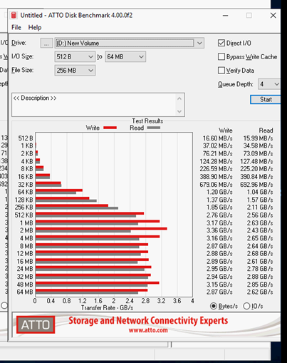

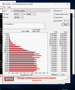

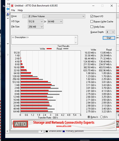

Just thew some more money at my system..(a small car's worth unfortunately) - This is with just 1 Mirrored Vdev with 2x HUSMR7619BDP3Y1 -
This is with NO slog - I've upgraded to a 40gbe interface (For this one ESXI NODE). - Ordered another SM NVME card - to have 2x Mirrored Vdev's -Curious why write seems to bottle neck 1gb - was same with optane 900 PCIE. (even over 40gbe)

SAS did help speed the system up. (Considering the SAS drives almost doubled my read/write alone) - So I got myself 22TB super fast array
My system numbers seemed pretty good -
"Throughput report Y-axis is type of test X-axis is number of processes"
"Record size = 1024 kBytes "
"Output is in kBytes/sec"
"  Initial write " 11665157.62
"        Rewrite " 8288589.09
"           Read " 15753663.44
"        Re-read " 15640108.69
"    Random read " 15953570.19
"   Random write " 7414903.09
But what I now realize my goals/expectations were a bit off.
IE -
Super fast array does not mean tons of pictures(small files) transfer really that much faster. ( Cut myself off before dropping more money doing a total 40gbe infrastructure) (I got one of those $50 40gbe mellanox InfiniBand switches, never got around to use it)
My VM's load pretty fast now. lol.
Wanted to try dual 40gbe port across my 3 node esxi cluster to a multipath ISCSI target.. Bet I could get some great numbers with sync write off too..

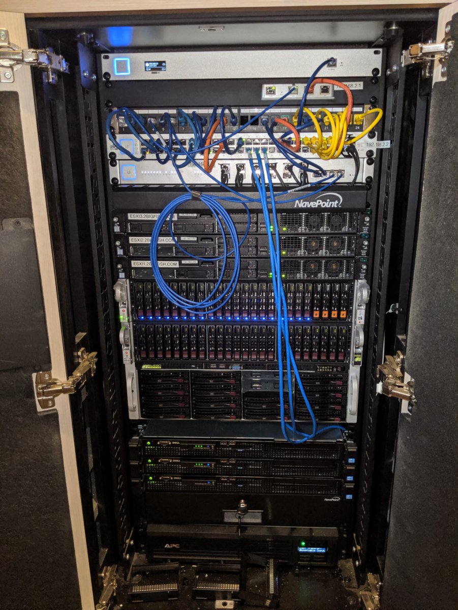

SuperMicro X9DRH-iTF, 2x E5-2570 v0 , 256GB Ram
1x BPN-SAS3-216A-N4
2x 9400-16i
1x 9300-8e
1x Intel 560SFP+ 10gb
2x AOC-SLG3-2E4 (PCIE to NVME)
4x Hitachi HUSMR7619BDP3Y1 (NVME) 1920GB
20x Toshba PX04SVB160 SSD (12Gbs/SAS3) 1600GB
As for Threads and Queue Depth - not sure. - This server me realize how out of my depth I am - But it works for now. (And sorta out PCIE slots so..)

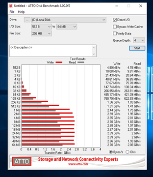

Because I just can't leave well enough alone..
Optimizations were just the standard freenas checkbox ones (auto)
Ordered some Cisco 40gbe BIDI optics - says they were compatible with my mellonox 40gbe - but nothing came up. ISCSI performance between windows 10 desktop and Freenas seemed much better than esxi (with sync on) - Got active 40gbe fiber coming next week to test more...
My DD numbers are similar between my 2 data pools (sas3 vs nvme) - a pair of dl380 G9 fell into my lap yesterday - wanting to test numbers on those with nvme (enablement kit - not sure if feasible or how many it can take - vs my 4x the SM chassis takes at the moment)

Still getting some odd numbers - Via ISCSI over 40Gbe (Sync Disabled)
Read's seem way to low..
And this is with NFS4 enabled on freenas (NFS3 wrote is ok, read is sub 600) (Sync Disabled)

For Kicks I installed server 2019 bare metal on one of my (currently former) esxi 6.7u3 boxes. Windows ISCSI to freenas seems more in line where I thought I should be. Why not just go with NFS4? - Well.. esxi doesn't share the datastore nicely across hosts - so instead I get datastore, datastore(1), datastore(2) - and vmotion doesn't care for that (since they are technically different).. so whats the point then?
At this point - I'm thinking I'd rather sell the 2x Supermicro NVME and 4x NVME drives - as it seems my SAS3 array performance gives better mid to top range
SAS3 (20x 1.6tb SSD raidz3, 1Vdev)
NVME (4x 1.92tb SSD Raidz1 2Vdev)
