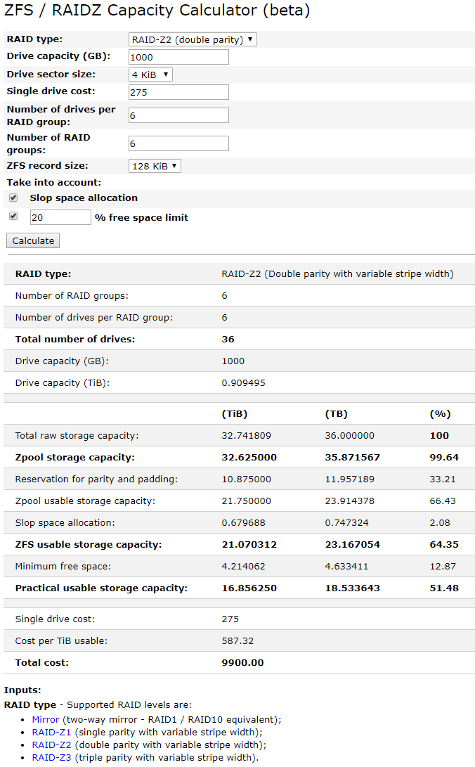

The short form of the answer, in ZFS, the pool is a collection of vdevs (virtual devices) all the vdevs in the pool are striped together like a RAID-0. So any data sent into the pool is split among all vdevs, so if a single vdev fails, the entire pool fails. Redundancy in ZFS is done at the vdev level, so a vdev might be a mirror (kind of like RIAD-1), or it could be RAIDz (kind of like RAID-5, 1 disk worth of parity), or it could be RAIDz2 (kind of like RAID-6, 2 disks worth of parity), or it could be RAIDz3 (kind of like RAID-6+, 3 disks worth of parity). For storing video (surveillance right?) you probably want RAIDz2 vdevs, and to ensure you have fast enough IO rate to deal with your data, you will want many vdevs. I would suggest going with either six or eight drives per vdev (probably six) so you can have more vdevs. It is generally not a good idea to have more than about ten drives in a vdev, but I have heard of a system where they put 45 drives all in a single vdev. The thing about vdev performance is that (for random IO) each vdev is generally equivalent to a single physical disk. All data written into the pool is automatically checksumed by ZFS so that it can be monitored for errors, regardless of the type of redundancy selected. General rule of thumb, if you need very high IOPS, for virtualization for example, you would use mirror vdevs so that you can have more vdevs without needing a massive amount of drives.
Here is a link to a capacity calculator that I like when I am trying to decide on the number of drives and the capacity of the drives for a particular project:
https://wintelguy.com/zfs-calc.pl
Here is an example with 1TB drives with 6 drives per vdev and 6 vdevs in RAIDz2, just ignore the price.

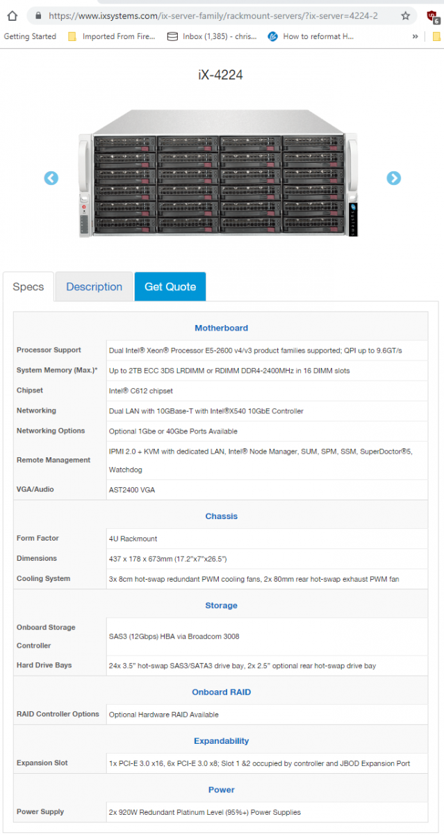

Just need to find all the parts - new.
The price will be much higher for new. Please be prepared for a shock.
Chris Moore
May 2, 2015
10,079
Looks good! Just need to find all the parts - new. And two 64GB SSDs. Thanks for the link!
If you are going for new hardware, you should contact ixsystems.com for a quote.
You can email them at: info@ixsystems.com or call them at: 1 (855) 473-7449 or 1 (408) 943-4100
Chris Moore
May 2, 2015
10,079
Here is an example from their site:
You just need to talk to them for a quote.
https://www.ixsystems.com/ix-server-family/rackmount-servers/?ix-server=4224-2

This is a significantly less valuable case. It has no hot-swap power supply included with it AND it also does not include a SAS Expander in the drive backplane, so there would need to be a separate SAS expander purchased and installed in the system. It is also (speaking of the materials) poorly made by comparison with the Supermicro chassis. It would be worth paying $400 more for shipping to get the Supermicro chassis alone.
If you are able to get the system board included with the chassis, that would make the Supermicro chassis worth another $600, just by not needing to pay that exorbitant price for a system board.
So, between the price of that system board, and the value difference for the chassis, the Supermicro chassis with included system board is worth at least $600 over their asking and as much as $1000 more, especially if the vendor can put a proper HBA in it for you.
As for the HBA. You would want one like this for the internal drives:
https://www.newegg.com/Product/Product.aspx?Item=9SIADP08R39851
and one like this for the externally attached drives:
https://www.newegg.com/Product/Product.aspx?Item=9SIAEWP6S29066
The one you were pointing out is a 12Gb SAS controller and there is just no reason for spending that much money for spinning disks.

BKG
Mar 11, 2019
18
