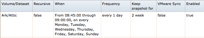

Nicola, I routinely use the solution that depasseg suggested. The main pool replicates to the backup pool daily, both in the same machine. It was a little tricky to set up (for me) but you seem pretty savvy so might be easy for you. FYI, here is one of the snapshot tasks for a datset (Attic) on the main pool (Ark):
And the corresponding replication task to send it to the backup pool (Arkbak):
Let us know if you hit any snags.
